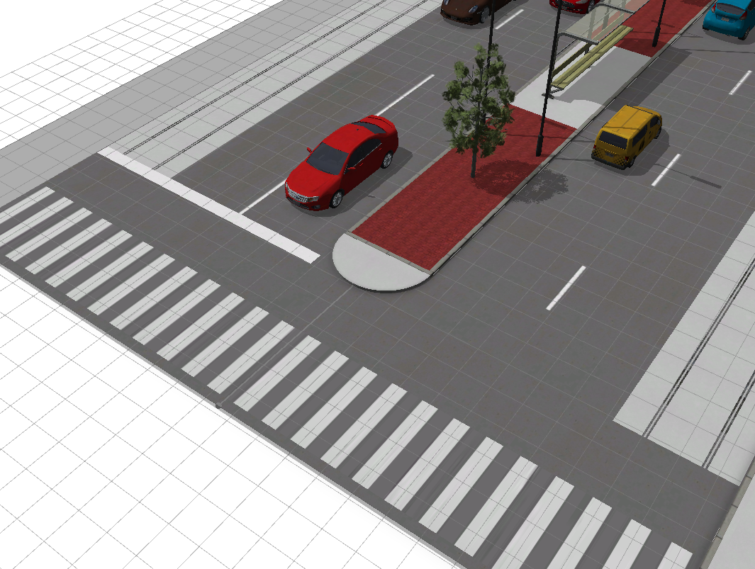

At first, I looked at the complete street code but never found out how it was creating the medians here:
I think those are created by the "street graphing" but I am not totally sure. I noticed that the texturing in the half-circle-top was always just concrete (not the offset curb with grass effect I was looking for).

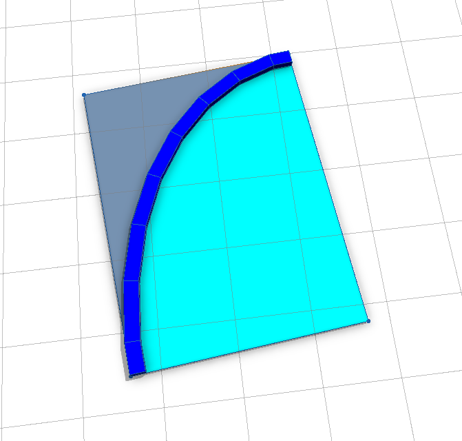

To start, I used a 32 sided primitiveDisk, which makes a good looking "circle". I applied the curb offset first, wondering how it would handle the longest edge, as I wanted that discarded. I divided it in half using a '50/50 relative' split along the x axis, and discarded the unused half with a NIL. Next step is offsetting the object by half the length of the starting object using the translate function and moving it -scope.sx/2. And the last trick was finding the right face, which in my code I use a 32 sided disk split in half, which produces 18 faces after the offset. I used a comp(f) function for all 18 faces but then made face #17 (the one I wanted) a different shape. (Code below)

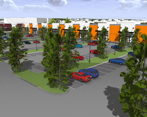

<SPAN class="line-numbers-rows"><SPAN></SPAN><SPAN></SPAN><SPAN></SPAN><SPAN></SPAN><SPAN></SPAN><SPAN></SPAN><SPAN></SPAN><SPAN></SPAN><SPAN></SPAN><SPAN></SPAN><SPAN></SPAN><SPAN></SPAN><SPAN></SPAN><SPAN></SPAN><SPAN></SPAN><SPAN></SPAN><SPAN></SPAN><SPAN></SPAN><SPAN></SPAN><SPAN></SPAN><SPAN></SPAN><SPAN></SPAN><SPAN></SPAN><SPAN></SPAN><SPAN></SPAN><SPAN></SPAN><SPAN></SPAN><SPAN></SPAN><SPAN></SPAN><SPAN></SPAN><SPAN></SPAN><SPAN></SPAN><SPAN></SPAN><SPAN></SPAN><SPAN></SPAN><SPAN></SPAN><SPAN></SPAN><SPAN></SPAN><SPAN></SPAN><SPAN></SPAN><SPAN></SPAN><SPAN></SPAN><SPAN></SPAN><SPAN></SPAN><SPAN></SPAN><SPAN></SPAN><SPAN></SPAN><SPAN></SPAN><SPAN></SPAN><SPAN></SPAN><SPAN></SPAN><SPAN></SPAN><SPAN></SPAN><SPAN></SPAN><SPAN></SPAN><SPAN></SPAN><SPAN></SPAN><SPAN></SPAN><SPAN></SPAN><SPAN></SPAN><SPAN></SPAN><SPAN></SPAN><SPAN></SPAN><SPAN></SPAN><SPAN></SPAN><SPAN></SPAN><SPAN></SPAN><SPAN></SPAN><SPAN></SPAN><SPAN></SPAN></SPAN>I intend to incorporate this into my parking lot code which is growing in complexity each day:
This picture of my parking lot does not have the half circle with curb yet, but it will once I get my "splits" and conditional rules all set up.

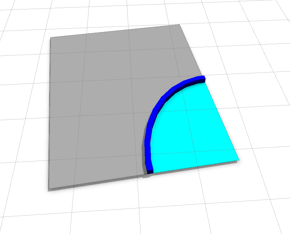

I'm curious if I can use another split, translate and/or scale function to create a quarter circle.

Update: Quarter Circle
* File: QuarterCirclewCurb.cga
* Created: 2 Jan 2020 14:32:08 GMT
* Author: bwamsley
version "2019.1"
const ShiftX = (scope.sx /2)
const ShiftZ = (scope.sz /2)
@Start
halfCircleSpace-->
alignScopeToGeometry(yUp,0,0)
primitiveDisk(32)
Circle
Circle-->
offset(-1)
split(x){'.5 : NIL
|'.5 : halfCircle}
halfCircle-->
split(z){'.5 : NIL
|'.5 : quarterCircle}
quarterCircle-->
translate(rel,scope,-ShiftX,0,-ShiftZ)
curbMaker
curbMaker-->
comp(f){0 : curb
|1 : curb
|2 : curb
|3 : curb
|4 : curb
|5 : curb
|6 : curb
|7 : curb
|8 : curb
|9 : GrassyArea}
GrassyArea-->
color(0,1,1)
curb-->
extrude(1)
color(0,0,1)

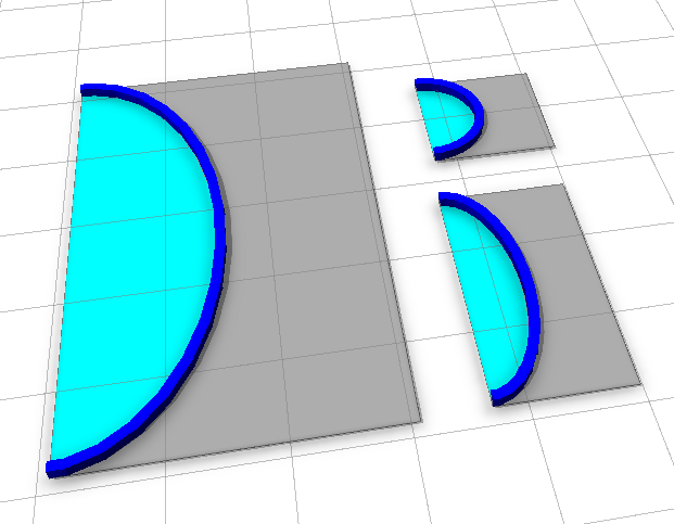

<SPAN class="line-numbers-rows"><SPAN></SPAN><SPAN></SPAN><SPAN></SPAN><SPAN></SPAN><SPAN></SPAN><SPAN></SPAN><SPAN></SPAN><SPAN></SPAN><SPAN></SPAN><SPAN></SPAN><SPAN></SPAN><SPAN></SPAN><SPAN></SPAN><SPAN></SPAN><SPAN></SPAN><SPAN></SPAN><SPAN></SPAN><SPAN></SPAN><SPAN></SPAN><SPAN></SPAN><SPAN></SPAN><SPAN></SPAN><SPAN></SPAN><SPAN></SPAN><SPAN></SPAN><SPAN></SPAN><SPAN></SPAN><SPAN></SPAN><SPAN></SPAN><SPAN></SPAN><SPAN></SPAN><SPAN></SPAN><SPAN></SPAN><SPAN></SPAN><SPAN></SPAN><SPAN></SPAN><SPAN></SPAN><SPAN></SPAN><SPAN></SPAN><SPAN></SPAN><SPAN></SPAN><SPAN></SPAN><SPAN></SPAN><SPAN></SPAN><SPAN></SPAN><SPAN></SPAN><SPAN></SPAN><SPAN></SPAN><SPAN></SPAN><SPAN></SPAN><SPAN></SPAN><SPAN></SPAN><SPAN></SPAN><SPAN></SPAN></SPAN>Update#2
Adding a simple s(ShiftX*2,0,ShiftZ*2) under the translate produces this:
quarterCircle-->
curbMaker<SPAN class="line-numbers-rows"><SPAN></SPAN><SPAN></SPAN><SPAN></SPAN><SPAN></SPAN></SPAN>
Imagine the possibilities for this guy!!! Building sidewalk borders, planter borders, etc.

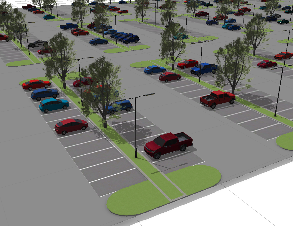

Extra: parking lot with half circles with curbs (need to tweak the textures still).
