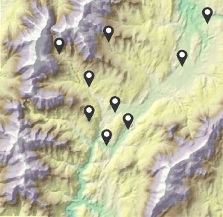

Use Case 1. Extract values from single raster at point locations
Say, you have some meteorological observation sites, and you would like to know the elevation of these locations.
For this case, the input would be a single elevation raster. You could use any of these three tools, since they all support single raster. Which one to use depends on what kind of output you need. For example, if you need to attach the elevation values to the input feature class’s attribute table, just use Extract Multi Values to Points.
