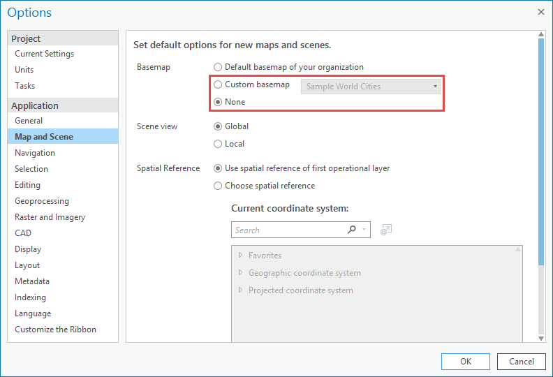

Change the default basemap option in a specific Project
ArcGIS Pro allows you to change the default basemap of new maps and scenes within a project. Use this option if you do not have administrative access in your portal.
- If have not opened a project, click About ArcGIS Pro. If you have opened a project, click the Project tab.
- Click Options.
- Click Map and Scene in the Application section.
- Choose either Custom basemap or None for the Basemap option.
- Click OK.
Figure 1: Setting the Basemap option in ArcGIS Pro.
