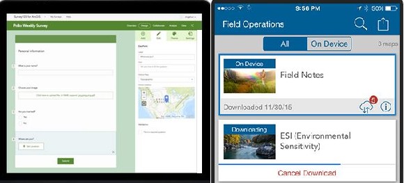

Various technologies help educators and students design surveys to gather data (including photos or other attached files), but Survey123 adds the great power of geography: What is the location about which the user is gathering data? Then, what patterns differ between here and there? The data collector can rely on a mobile device’s GPS or choose the location on a map. However, K12 student data collection often needs to be done offline (out of wifi coverage, without consuming cell data; think “airplane mode”), and Survey123 does not currently include an easy, browser-only mechanism for acquiring and using a high resolution basemap offline ... but Collector does!
Survey123 and Collector are not identical in the data they handle and ways they do it, so a survey being planned for use with Collector needs careful attention to design. Collector handles well the most critical field types for surveys in schools: text fields, numbers (both integer and floating point), single choice (radio button or pull-down), file attachments, and point location. Any ArcGIS Org login with publishing privilege may use Survey123 to design a survey with these components, publish it (which creates an editable feature service offering attachments), set the layer permissions for syncing, create a map with that service as a layer, and share the layer and map with a group. Group members with Collector on their mobile devices can access the map, download a relevant basemap, and be ready to use the survey offline.

- Only the survey creator needs to be a publisher and familiar with Survey123, but building the survey with students as a group process helps them see why and how choices get made
- All survey users need the Collector app on their mobile device
- The map with the editable feature service must be shared to a group in the ArcGIS Org, and all survey users must use a login that is a member of that group
- The survey form should focus on the basic question types noted above, and flow through all questions from beginning to end without “branching”, so “required” questions and question sequence need to be considered and designed carefully
- Question formats, hints, and defaults need to be planned and tested carefully so each question operates as expected
- Downloading the basemap in Collector requires attention to map extent and zoom scale, to optimize utility while minimizing bandwidth consumed and storage space required
- Uploading from Collector the collected data needs planning to minimize network strain (lots of people uploading lots of points with lots of high res images can tax even strong networks)
- Careful testing and piloting of the entire process (even going through a complete but very small practice activity with students) is advised before embarking on a large project. Best-laid plans can be tripped up by a tiny mistake or overlooked element.
