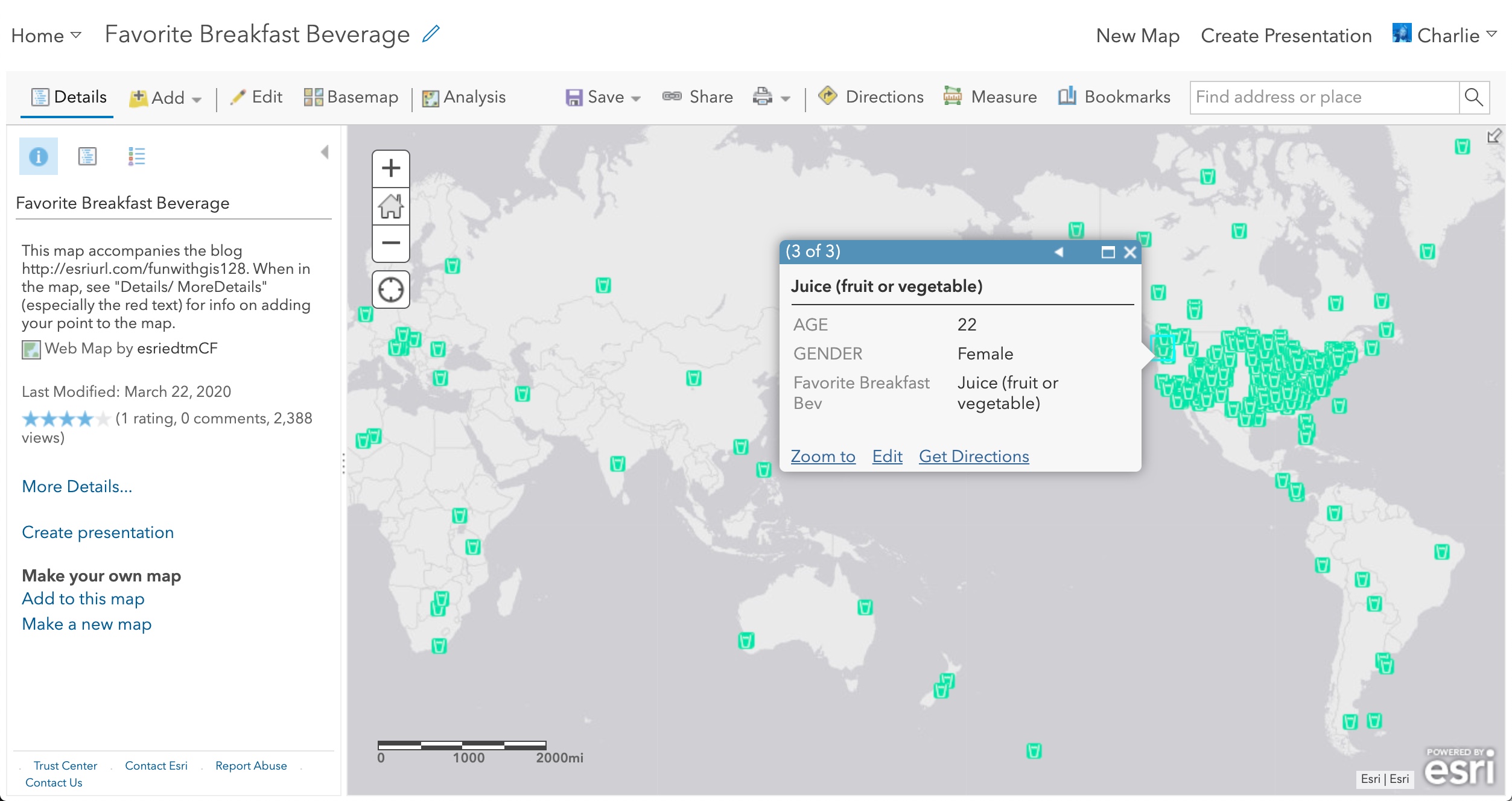

- Generate a new map with the test survey data; symbolize the data, set the popups, set the bookmarks; save the map, share the map to a dashboard.
