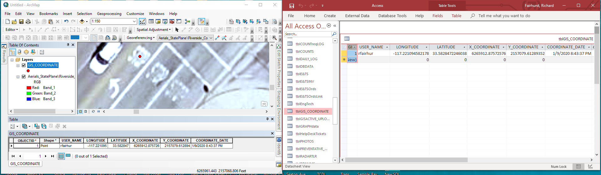

It is possible to create an ArcMap Python Addin tool that simultaneously captures clicked map coordinates stamped with a user name and date time in an ArcMap layer displayed on a map and collect them into a table in a Microsoft Access database housed on a shared network drive. The tool outlined in this blog only keeps track of the last coordinate clicked by each user in the Access coordinate table with the expectation that these records would be used like a clipboard by custom Access forms that control the creation or editing of records within Access. However, the tool code presented here could be modified to directly update any Access table from within ArcMap if prompts are added to the tool that let the user choose the Access records they want to create or edit as a result of each mouse click.

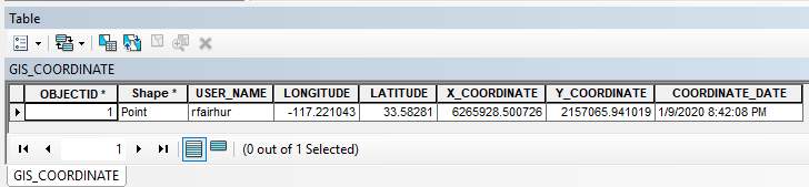

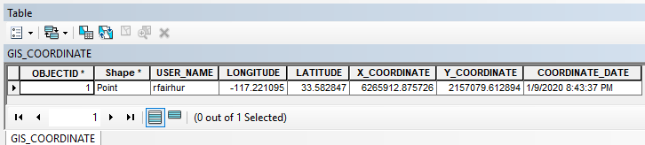

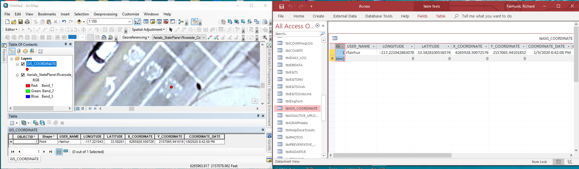

The pictures below shows the result of using the tool to capture the location of two different STOP markings on a road. The table records in ArcMap and Access match completely after simply activating the tool and clicking on each marking.
The tool only activates when the left mouse button is clicked within a map and the Alt, Ctrl and Shift keys are not being pressed. I created the Access tblGIS_COORDINATE table manually, but the ArcMap GIS_COORDINATE feature class will automatically be created by the tool if it doesn't exist in the default database and be added to the map as a layer and made visible if it is not currently a layer in the map or visible when the mouse is clicked. The tool ensures that the cache is cleared if the GIS_COORDINATE table view is open so that it will refresh to match the point location on the map and you may have to make Access the currently active program to see its table refresh if it is open.

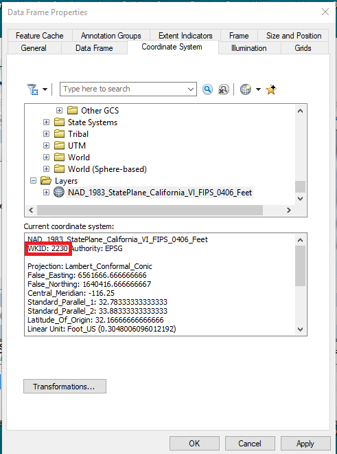

If you get an error about the odbcji32.dll required to use the {Microsoft Access Driver (*.mdb, *.accdb)} you can follow the instructions at Unable to load odbcji32.dll (MS Access ODBC driver)
The tool captures coordinates in both the State Plane Spatial Reference preferred by my jurisdiction and in the GCS WGS 1984 Spatial Reference used by Google maps. You should change the State Plane Spatial Reference to your own preferred Spatial Reference. You can find the WKID of your preferred Spatial Reference by adding a layer that uses that Spatial Reference to your map and opening the Data Frame Properties dialog, choosing the Coordinate System tab and choosing the Spatial Reference under the Layers group at the bottom of the list.
