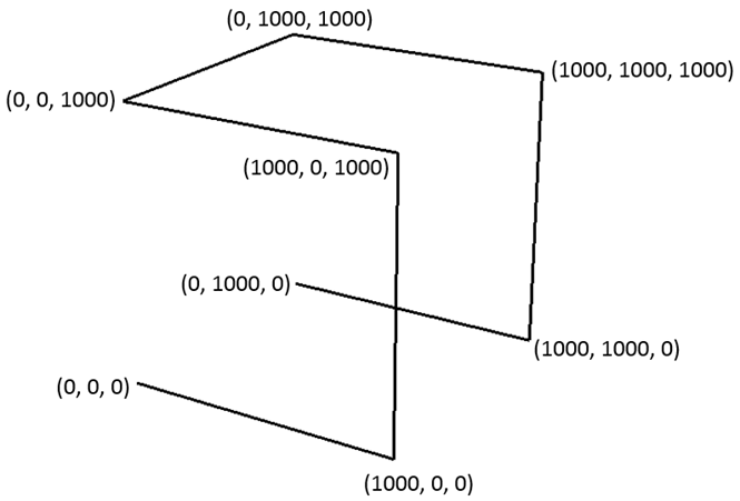

Creating 3D lines and polygons is not very different. Instead of providing a single point you will provide an array created from a list of points. Consider the script below:
import arcpy
import os
arcpy.env.overwriteOutput = True
# create spatial reference (WGS_1984_Web_Mercator_Auxiliary_Sphere)
sr = arcpy.SpatialReference(3857)
# list of x, y, z tuples with coordinates of points
lst_crds = [(0, 0, 0), (1000, 0, 0),
(1000, 0, 1000), (0, 0, 1000),
(0, 1000, 1000), (1000, 1000, 1000),
(1000, 1000, 0), (0, 1000, 0)]
# create a point for each x, y, z tuple in the list and append it to the list of points
lst_pnts = []
for crds in lst_crds:
pnt = arcpy.Point(crds[0], crds[1], crds[2])
lst_pnts.append(pnt)
# create polyline with Z, but without M
polyline = arcpy.Polyline(arcpy.Array(lst_pnts), sr, True, False)
# create a featureclass with the Polyline Z geometry
ws = r'D:\Test\data.gdb'
fc_name = 'polyline_z'
fc = os.path.join(ws, fc_name)
arcpy.CopyFeatures_management([polyline], fc)
When you visualize the line 3D you will see something like this:

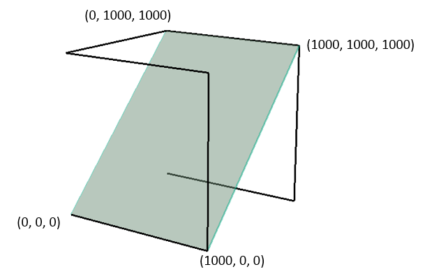

To create a polygon is very similar to creating a polyline. They both require an array created from a list of points (not PointGeometries). The difference is that for a polygon you repeat the first point as last point to close the polygon.
Observe the snippet below:
import arcpy
import os
(1000, 1000, 1000),(0, 1000, 1000),
(0, 0, 0)]
lst_pnts = []
# create polygon with Z, but without M
polygon = arcpy.Polygon(arcpy.Array(lst_pnts), sr, True, False)
# create a featureclass with the polygon Z geometry
fc_name = 'polygon_z'
arcpy.CopyFeatures_management([polygon], fc)
Which will create a tilted rectangle:

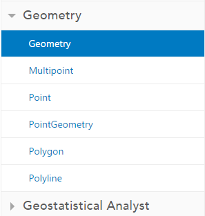

So what about Multipatches in Arcpy?
When exploring the objects present in the arcpy.geometries module, I discovered that there is a Multipatch class, which inherits from the Geometry:
Looking at the latest documentation of Arcpy inside ArcMap and ArcGIS Pro shows no sign of Multipatches. So
Geometry—ArcPy Classes | ArcGIS for Desktop (Pro) and Geometry—Help | ArcGIS for Desktop (ArcMap)
both show this:
… and searching for it does not return any results:
Trying to create a Multipatch object with the same points we used for the simple 3D polygon, results in:

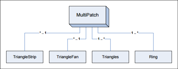

Exploring the definition of the Multipatch in this whitepaper:
https://www.esri.com/library/whitepapers/pdfs/multipatch-geometry-type.pdf
… learns us that the Multipatch object (in ArcObjects) is created from TriangleStrips, TriangleFans, Triangles and/or Rings:
None of which are present in the arcpy.geometries module.
