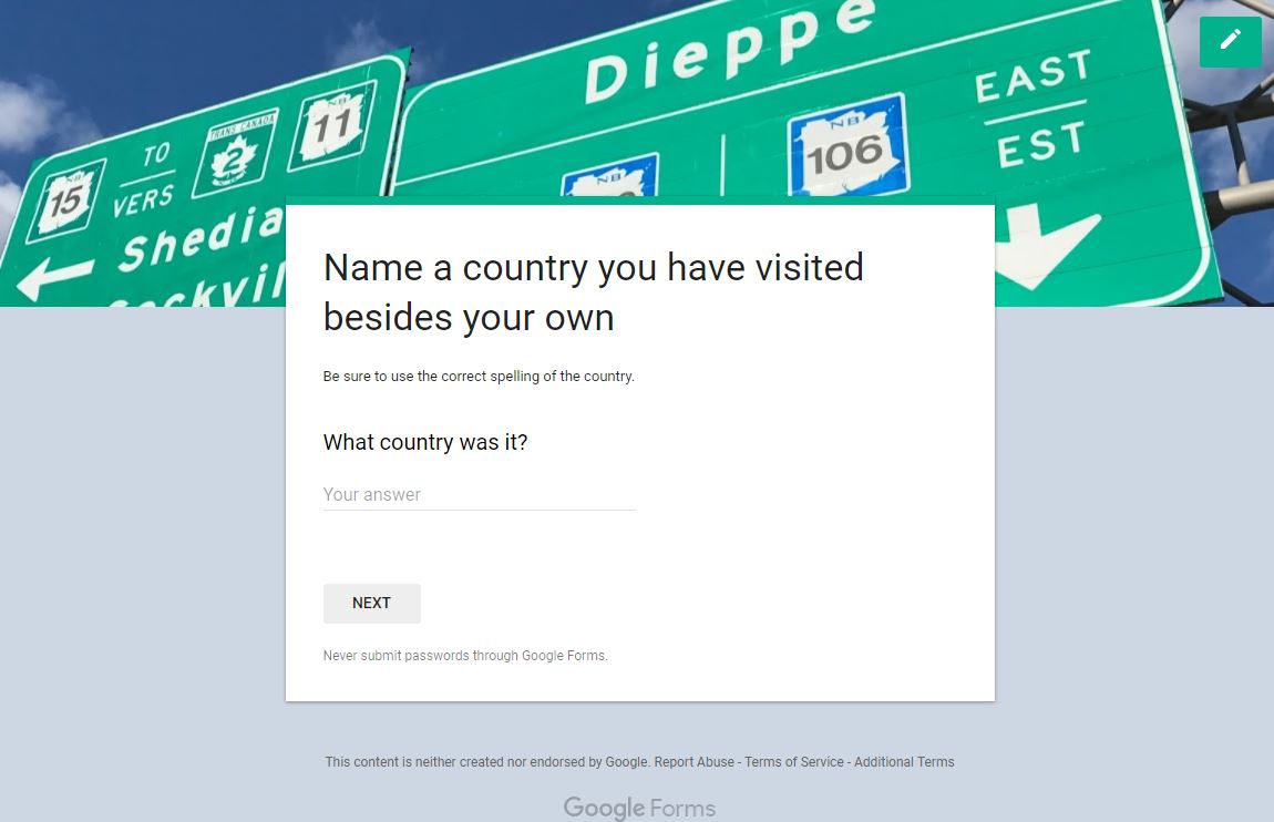

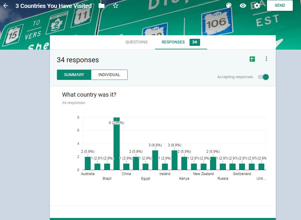

Both of these scenarios are possible with ArcGIS Online. To illustrate, I created a form where students are asked, "What country have you visited?", shown below.

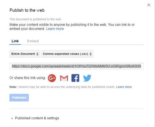

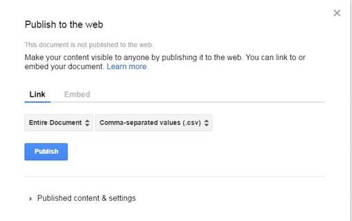

After students fill out the form, I go to the "responses" zone in Google Forms, and access the spreadsheet that is created from the data. Now that my data is in my Google Sheet, I access > File > Publish to the Web > and change "Web Page" to "Comma Separated Values (.csv)" file > Publish.
Then, I copy the resulting URL:

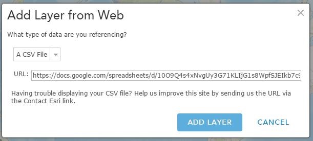

Then, I access my ArcGIS Online account, open a new or existing map > Add > Add Layer from Web - CSV file > paste your URL for my Google Sheet here.
Next, I > Add Layer > I indicate which fields contain my location information (address, latitude-longitude, city/state/country combination).

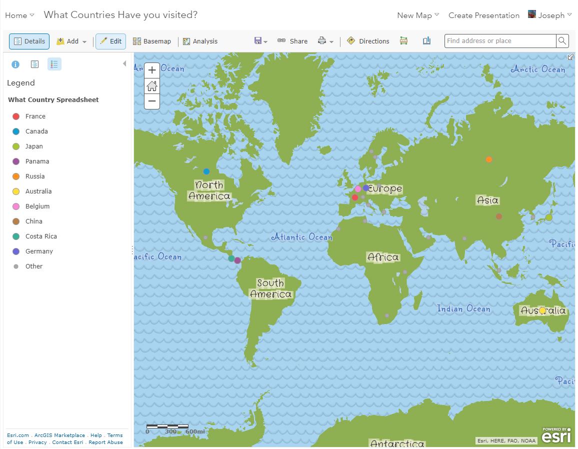

My results are in this map linked here, and shown below:
Note that I used one of the fun new basemaps in ArcGIS Online that I wrote about here.

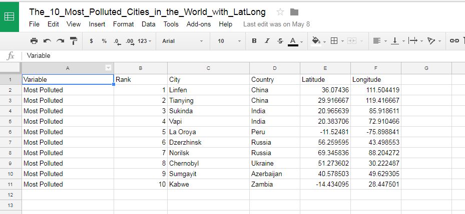

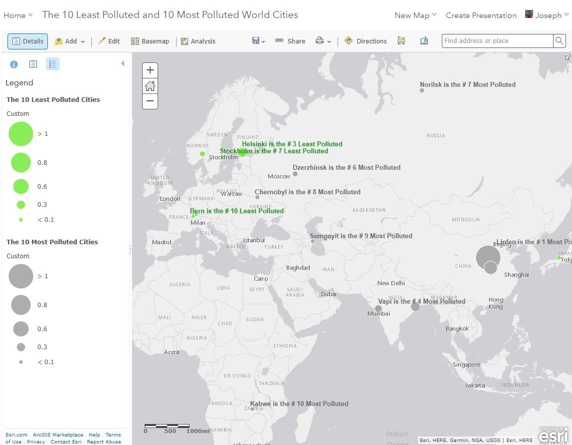

In another example, this time using cities instead of countries, see this map of the 10 most polluted and 10 least polluted large cities of the world. Students examine spatial patterns and reasons for the pollution (or lack of it) in each city using the map and the metadata here. I created this map by populating this Google Sheet, below. My students could add 10 or 20 more to this sheet and their changes would be reflected in my ArcGIS Online map.
Here is the map from the data, below. For those explanatory labels, I used this custom label expression:
$feature.City + " is the #" + " " + $feature.Rank + " " + $feature.Variable and set the text color to match the point symbol color for clarity. For more about expressions, see my blog post here.

Let's explore a bit deeper. Let's say that I wanted to visualize the most commonly visited countries among my students. I can certainly examine the statistics from my Google form, as seen below:

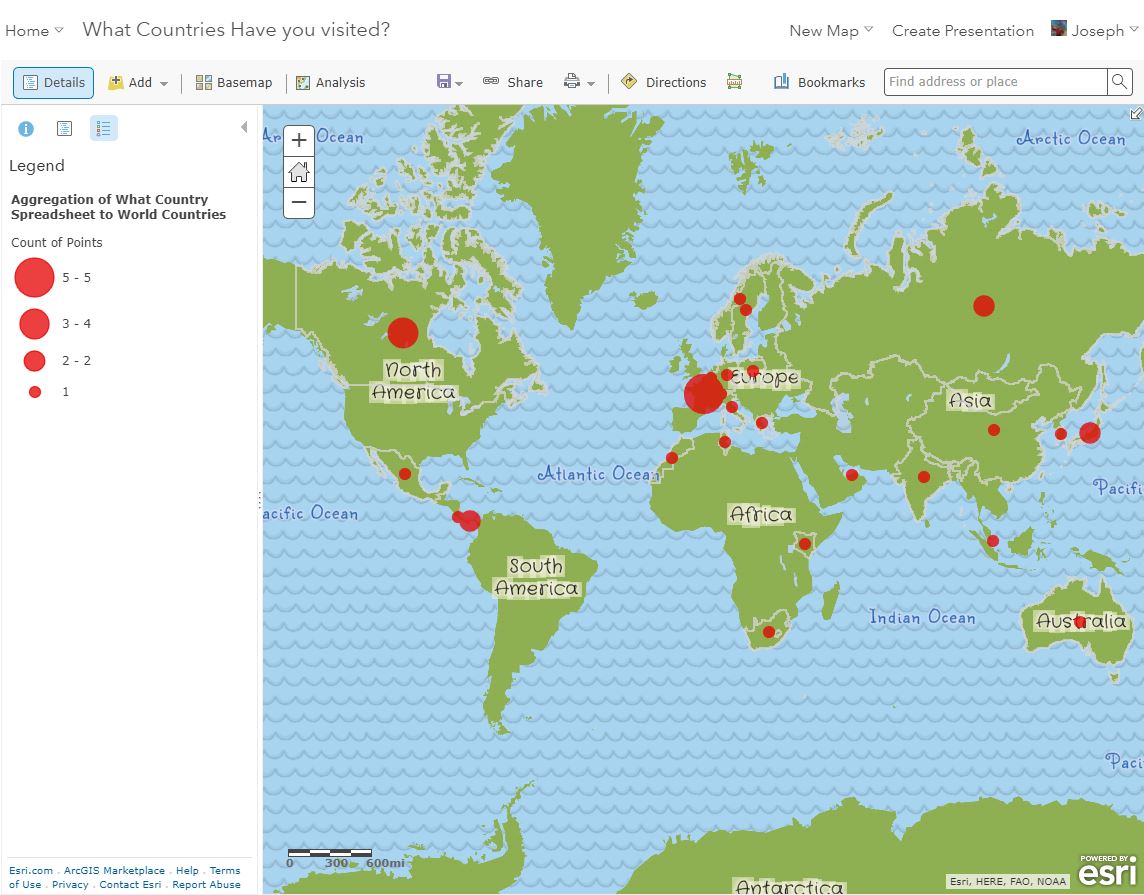

However, my goal is really to see this data on a map. With the analysis tools in ArcGIS Online, this too is quickly done. The Aggregate Points tool will summarize points in polygons. For my polygons, I added a generalized world countries map layer, and then used Aggregate Points to summarize my point data within those countries. The result is shown below and is visible as a layer in the map I referenced above.

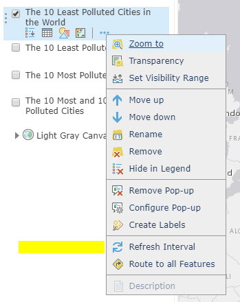

Another point worth noting is that you can adjust the settings of how your map interacts with your Google Sheet. Go to the layer's metadata page, and under “Published content & settings”, select "Automatically republish when changes are made." You can set the refresh interval to, for example, 1 minute, but the actual refresh on your map may take somewhat longer because Google’s “Auto re-publish” isn’t quite "real-time". Then do the following for the layer:

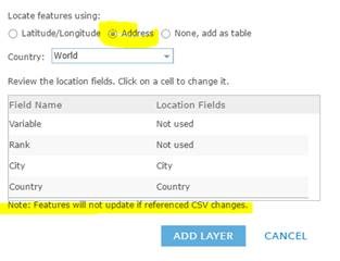

Note that if you are geocoding by address (such as city/country, as I did above, or street address), the automatic refresh option is not available:
To get around this challenge, I manually added the latitude-longitude values to my cities spreadsheet. Thanks to the Measure tool in ArcGIS Online, this took less than 1 minute per city. I simply typed in the city name in ArcGIS Online, and used the Location button under the Measure tools, clicked on the map where the city was located, and entered the resulting coordinates into my spreadsheet.
