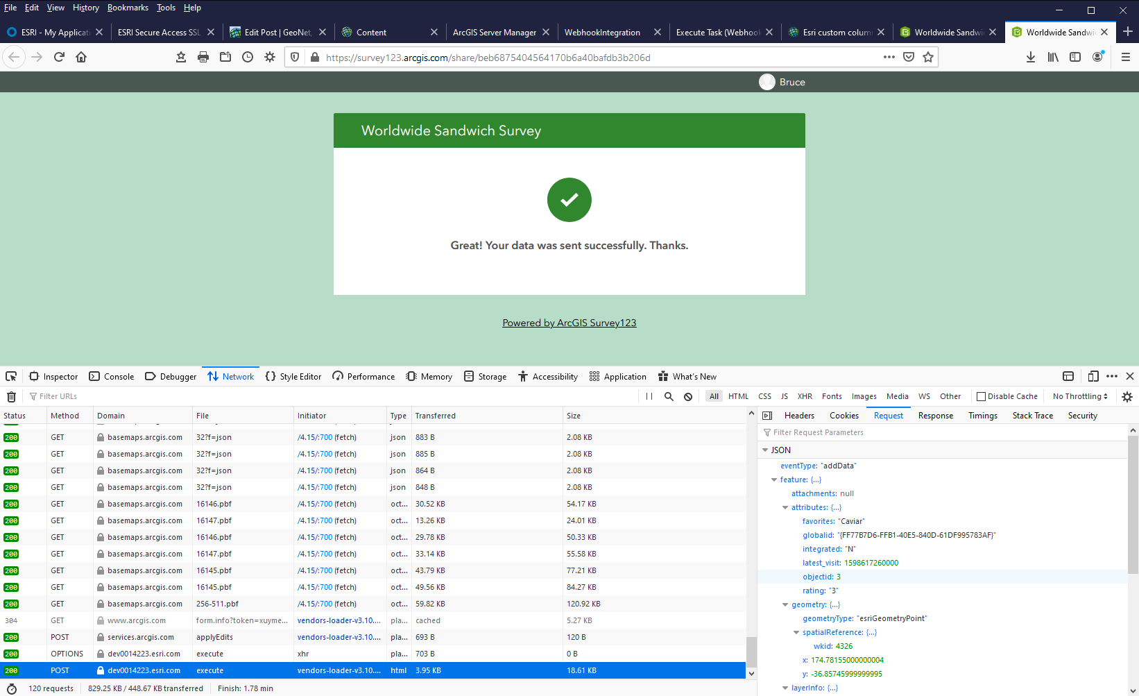

I'm going to jump ahead now to explain how to avoid what might present as a silent failure of your webhook. Survey123 (i.e. https://survey123.arcgis.com) will be calling your server with a POST request, so it needs to be trusted. Below is a screen grab of my browser while I submit a survey, with the debugger pane open (Firefox). I have highlighted the POST request sent to my server - it worked. If your server rejects a request from Survey123 you'll see error messages talking about CORS - cross origin resource sharing.
See this topic about how to allow Survey123 to access your server - Cross Origin Resource Sharing.

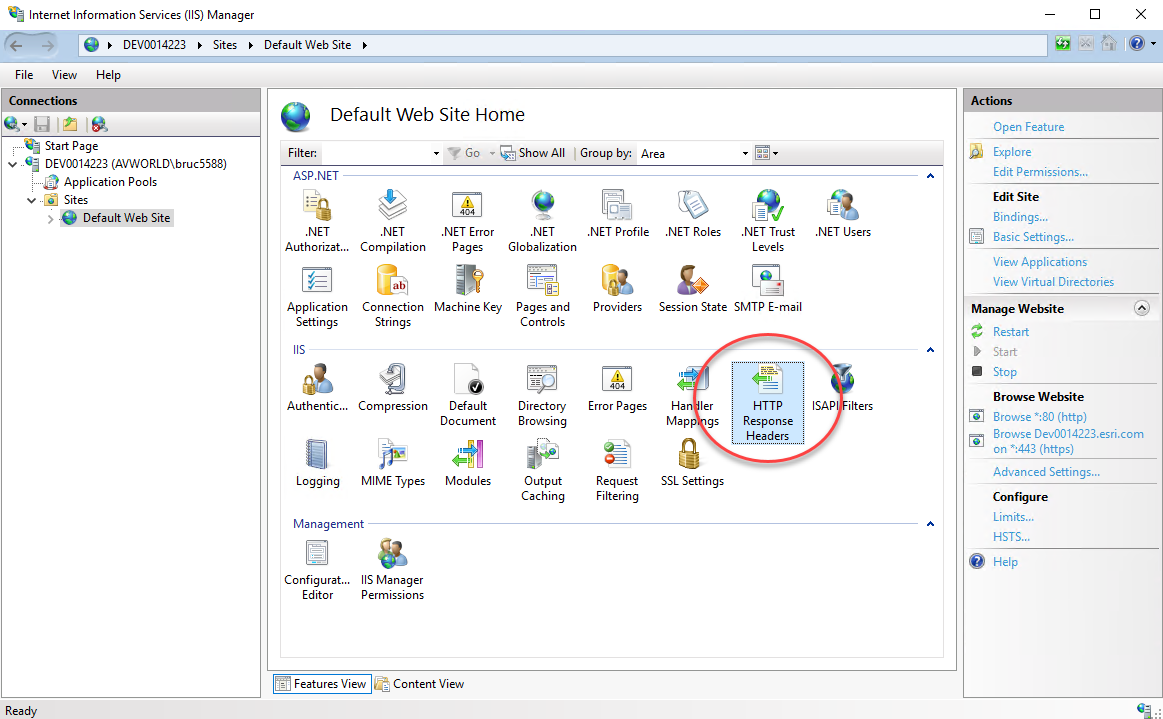

For me this setting wasn't enough, I also had to change HTTP response header settings in IIS. On your server, open IIS at the HTTP Response Header control, double click to open it and Add what you see below.

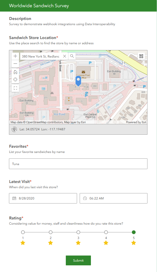

First though, create your survey. Here is mine:

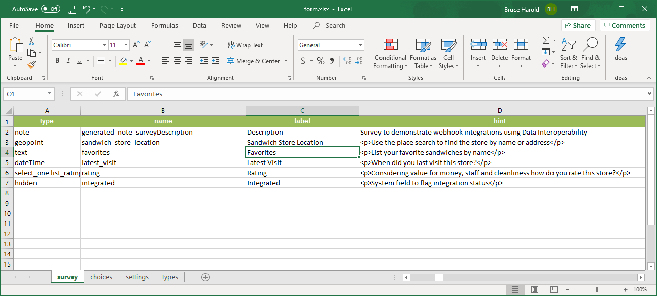

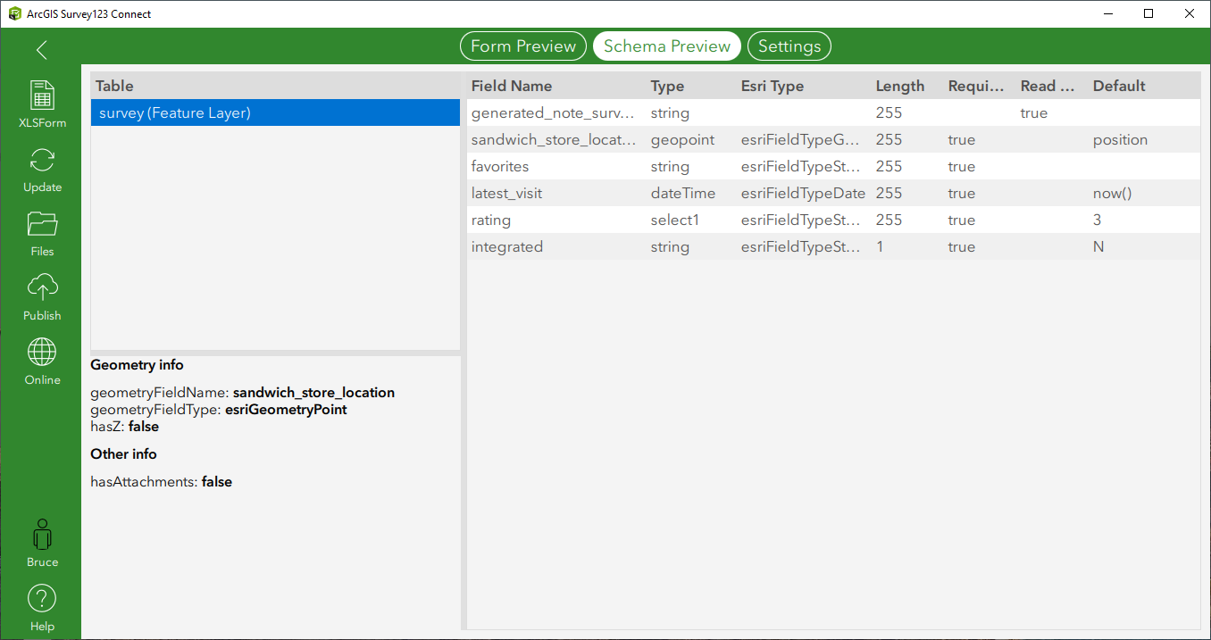

When a survey is submitted a feature is written to its feature service and then any configured webhook is triggered - you can see the applyEdits POST in my browser debug view above, ahead of the webhook POST. To support the integration geoprocessing service finding new records, my survey contains a hidden, required question 'Integrated' with a default value of 'N', which my integration edits to 'Y'. I created my survey in the web designer, which doesn't support hidden questions, then I edited it in Survey123 Connect to add the question, here is how it looks when edited:
And when saved to the survey:
You have to update and republish the survey to apply the schema change.

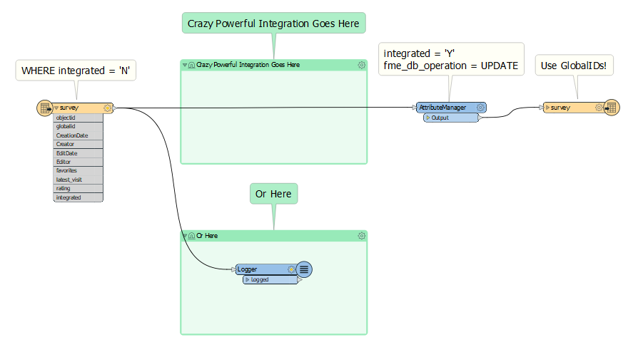

So now my survey has a field I can use as a processing selection flag. I created a couple of records so I could design the integration workspace, and here it is:
Its also in the blog download. It doesn't do any actual integration - that's your job - but you can see the pattern. Read records where integrate = 'N', do your stuff, then update integrate to 'Y' and write back to the service with GlobalID as the key field. Make sure your tool source is embedded.
If you have a large number of collaborators in your survey and by chance two surveys are submitted simultaneously it doesn't matter if one execution processes two surveys and another none. If you're worried about latency of surveys writing to the feature service then begin your process with a Creator-Decelerator-FeatureReader combination.

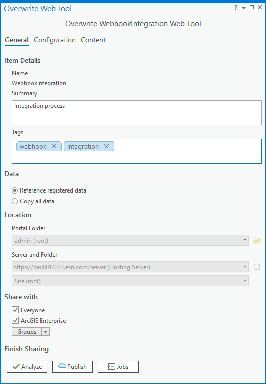

I manually tested the processing before publishing a web tool by submitting surveys and running the tool in edit mode. At that point I'm ready to share the web tool. Run the tool from the toolbox to create a History item then share it. You'll notice the service is to be public, if that can't be done at your shop then take Survey123 onto your enterprise infrastructure.

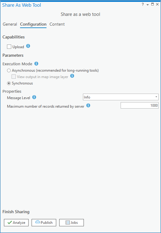

Make the tool synchronous for a start. If you find your available instances can't keep up move to asynchronous.
My tool has no parameters.

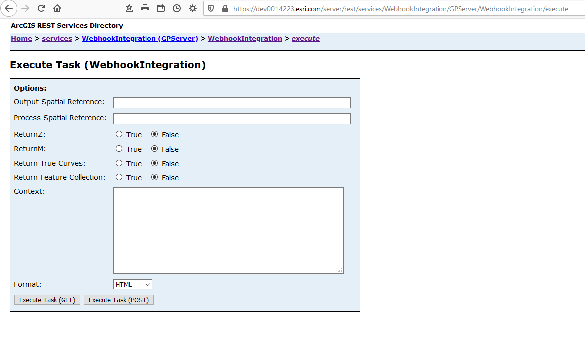

When it completes sharing, go to the service URL and copy the value, here is mine:
So my webhook URI is: https://dev0014223.esri.com/server/rest/services/WebhookIntegration/GPServer/WebhookIntegration/execute

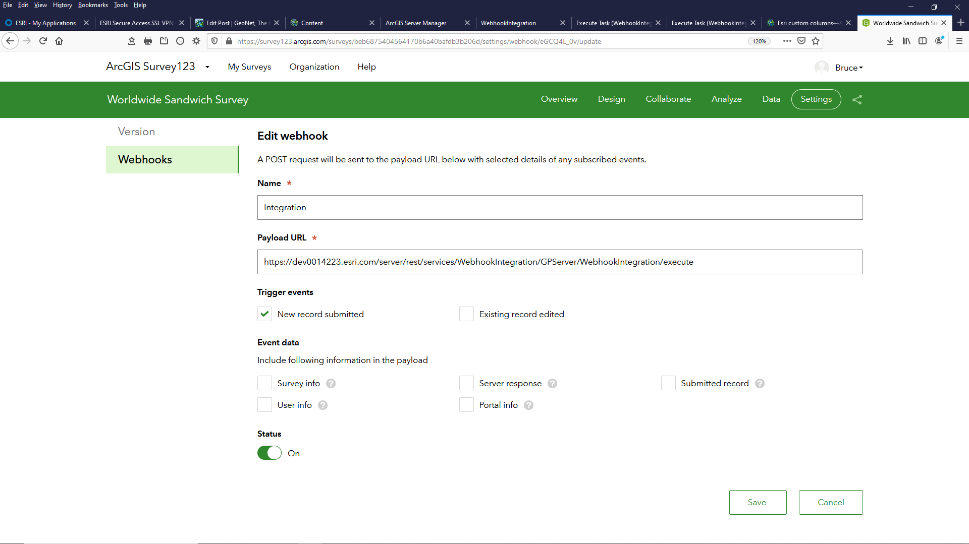

Now all that remains to do is configure the webhook in my survey.

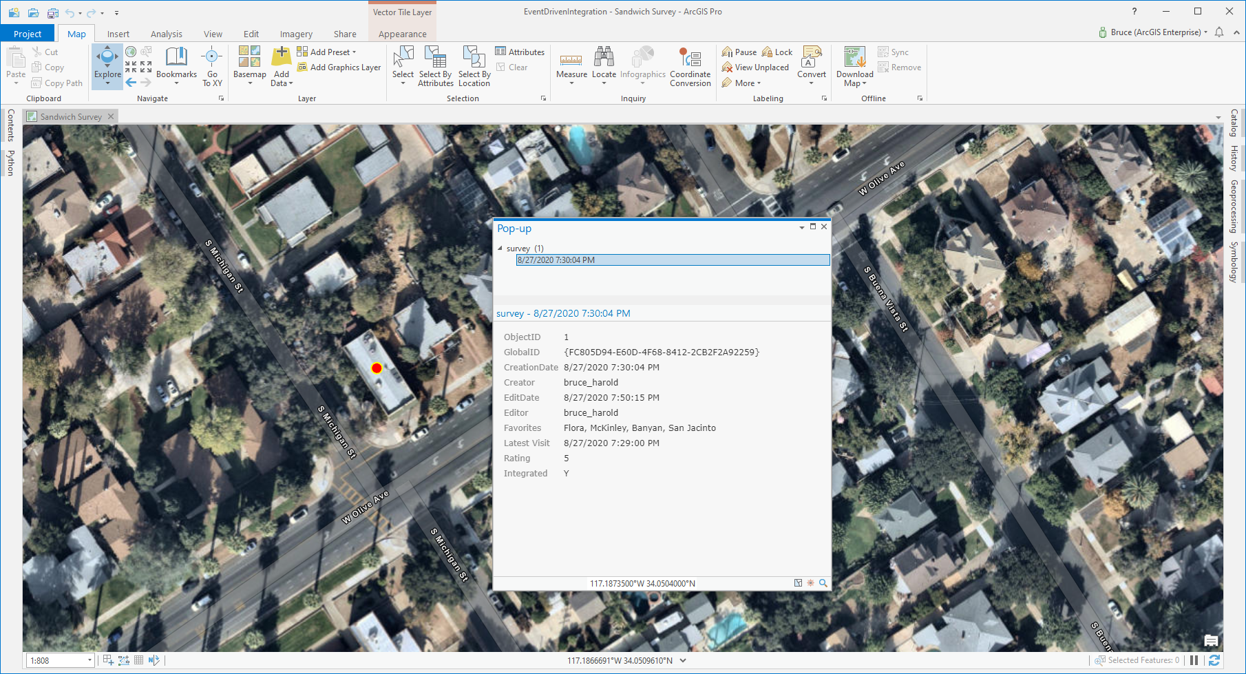

Now when a sandwich survey comes in my webhook integration triggers and Integrated = 'Y'.
