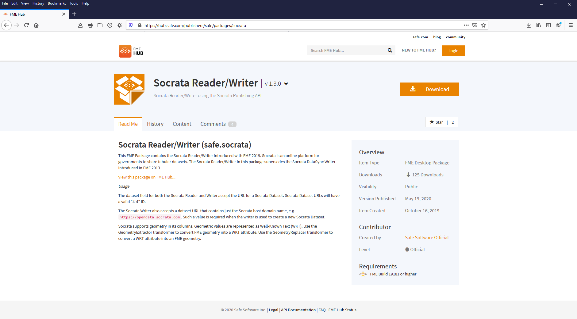

FME Hub is the default source for packages. Workbench supports browsing Hub, or you can use a web browser. In the screen grab below I have gone to the home page for a package that will provide support for reading and writing Socrata portal technology data.

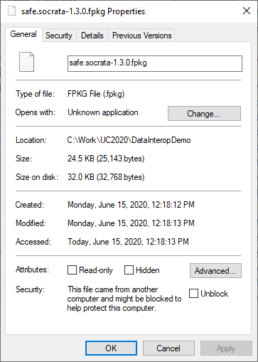

Download the package to your machine. You'll get a file with the extension .fpkg.

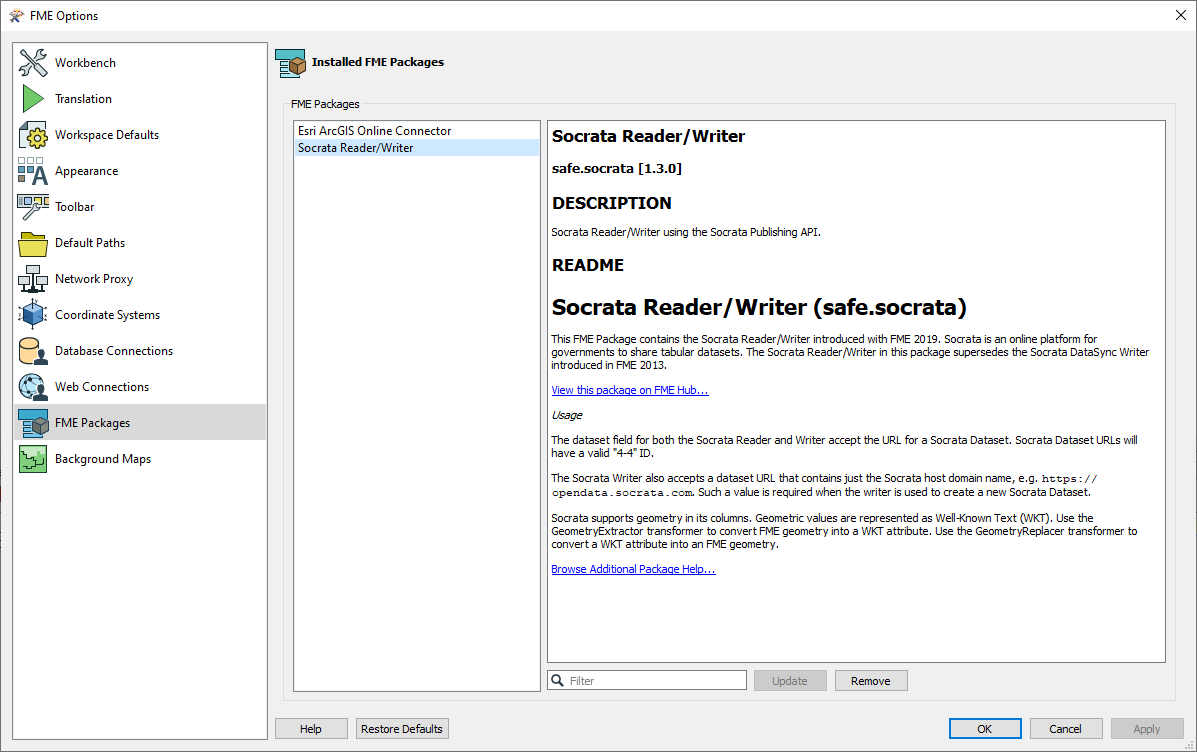

Packages from FME Hub are maintained and therefore have versions. To check if a new version exists, open the FME Packages view of the FME Options dialog and see if the Update button is enabled.
Note the package installs into a user profile directory. At present FME packages cannot be installed at a location shared by multiple users, each user must install the package(s) they require.

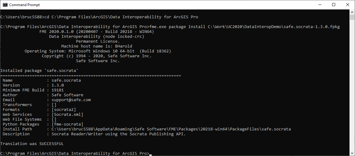

There is also a command-line option for listing, installing and uninstalling packages using the fme.exe executable:

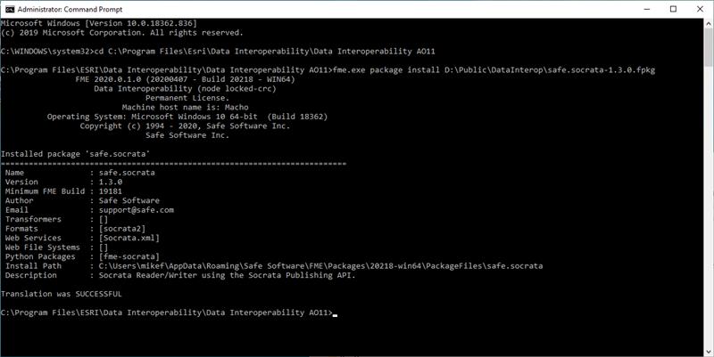

To successfully share web tools leveraging packages, each package must be installed into the target environment by the server account user on each server machine. Otherwise the experience is the same as the command-line option for desktop machines. Log into each server as the server account user, change directory to the appropriate path from the table above, then install each package. Here is an example installing the Socrata package for the Pro web tool case (apologies for the image being a little smaller).
