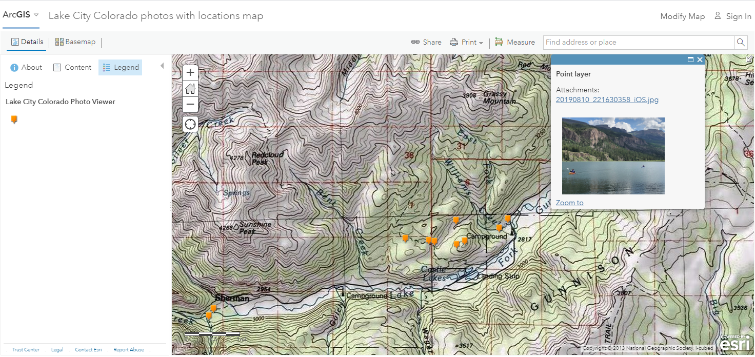

But let's say you want the photos to appear as thumbnails inside the popups. For example, see this map and screen shot below containing photos I took on a hiking trip to beautiful southwest Colorado. I did this by (1) configuring the popup, and (2) in the attribute expressions zone of the popup configure tools, I added a few lines of Arcade expressions as explained by my colleague Jennifer Bell, here. In essence, each photo is stored as an "attachment" in ArcGIS Online, and each is stored with an ID number. The Arcade expressions (1) Calculate the attachment ID for each feature, and (2) Configure the pop-up to display the attachment URL as an image.

In the map, I have, fittingly, used the USGS topographic maps as a base map, via Modify Map > Add Data > search for and add "USA Topo Maps". I have clicked on one photo in the screenshot below, but using the map link above, you can interact with it and examine more photos on this amazing landscape. In each popup, you can click on the link for the full sized image. One of the full sized images is here, for example, and also shown at the end of this essay.

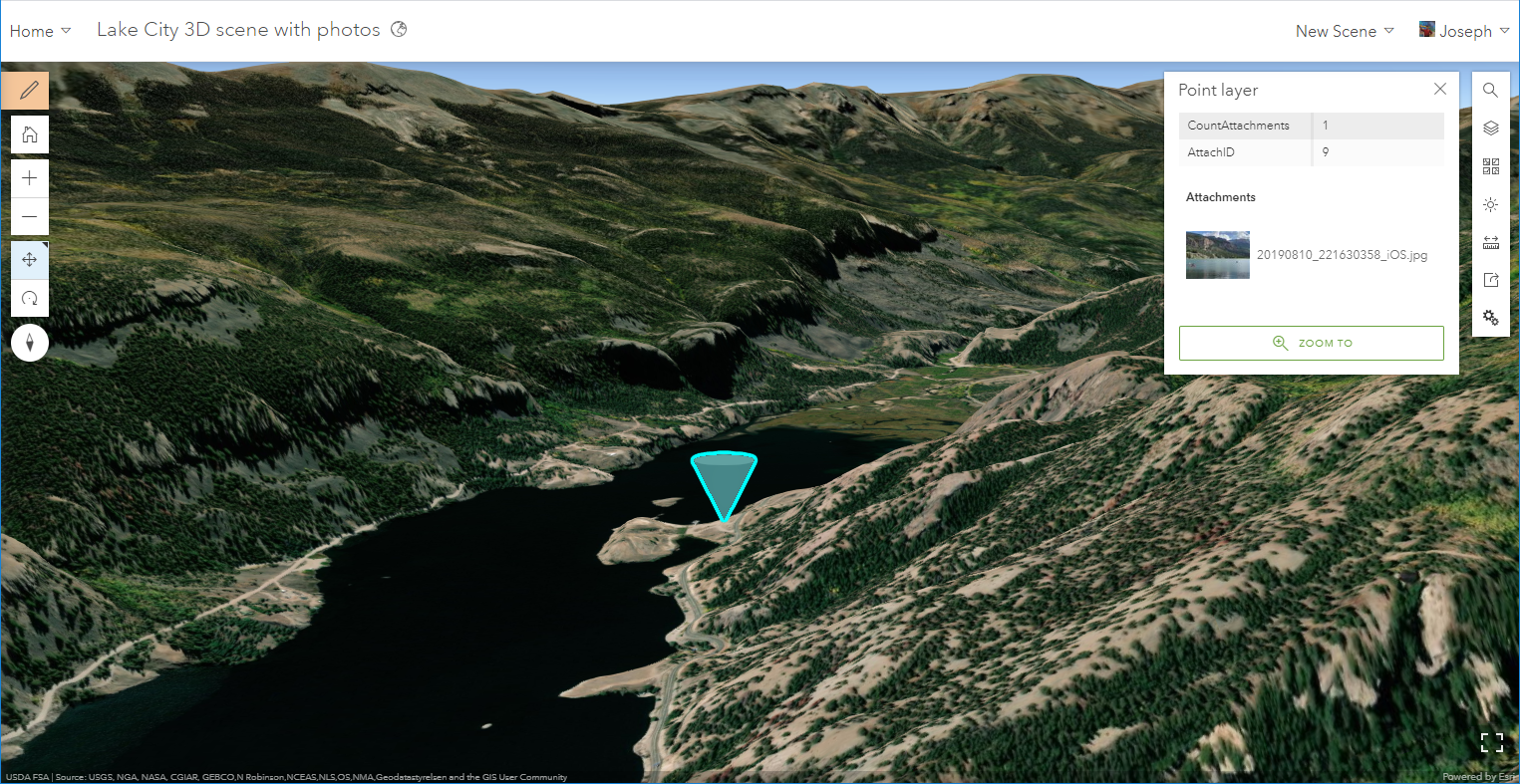

There are several advantages to the "photos with locations" method in education and beyond. First, the photos are stored in ArcGIS Online, so there is no need to use Flickr or other photo sharing tools, which, as I have documented here on GeoNet, frequently present challenges. Second, the resulting layer is a feature layer, rather than simply points being stored in a map, and so has some powerful functionality--you can bring the layer into ArcGIS Pro, ArcGIS Insights, or Community Analyst, to perform additional analysis on it. In my case, bringing the layer into a 3D scene is especially appropriate, as shown below. You can also use it in a storymap. Third, the popups are automatically configured. You can of course add additional information to the popup. Fourth, maybe the best part of all, the whole process takes mere minutes from the zipping to the mapping.
3D Scene of the photos with locations layer.

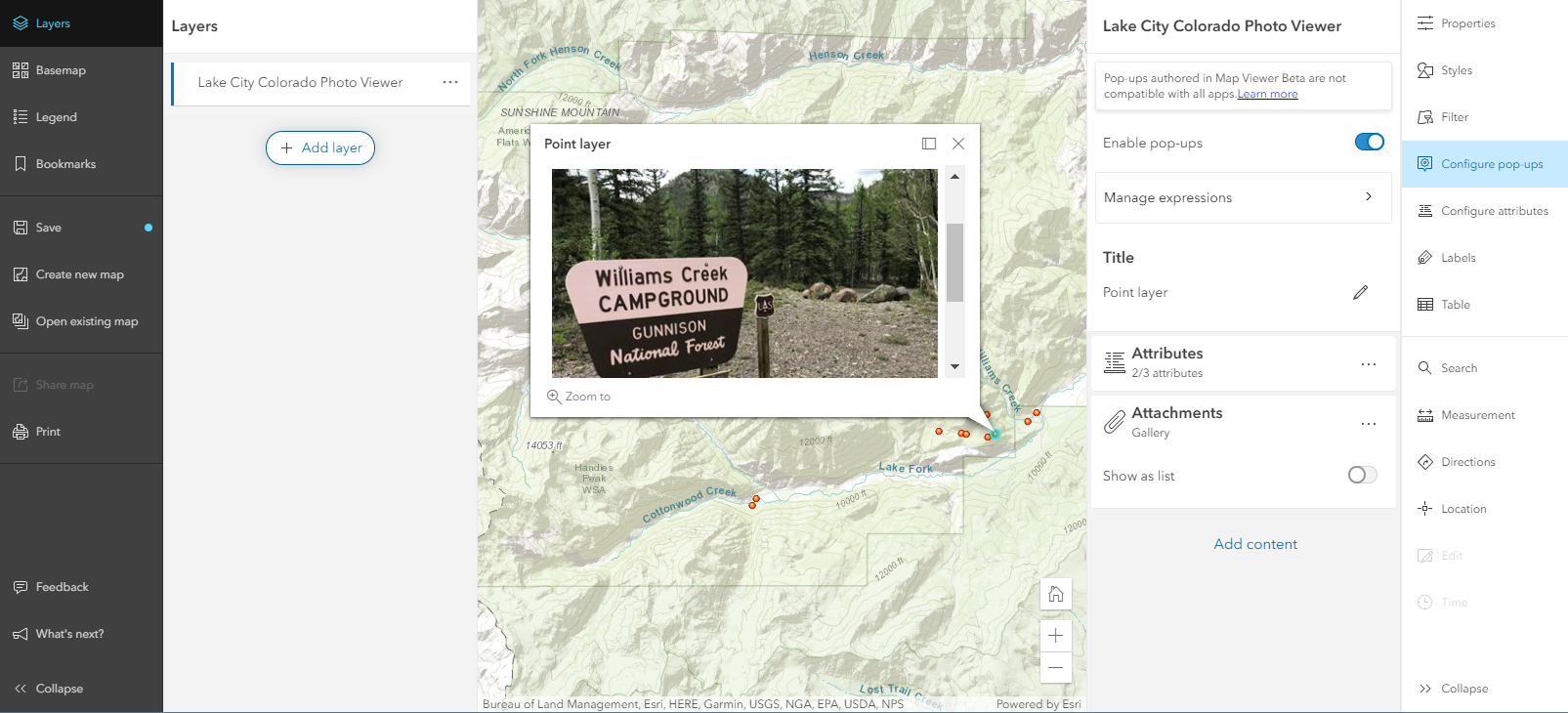

And there is more to come! In the new map viewer, popups have been improved in many ways, as explained here. See the improvements already in the beta release, below, you will notice a decent sized thumbnail for every one of my points without any custom code or manual insertion of URLs. The default popup mode is "list", which shows a tiny thumbnail, but if you use attachments > and uncheck "show as list", the images convert to a "gallery" mode, shown here.
Images in popups as shown in the new ArcGIS Online Map Viewer.
