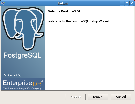

- Launch the installer by issuing the below command
./postgresql-9.2.2-1-linux-x64.run
- NB.
- Must have 755 rights on the above *.run file
- Must install as root
PostgreSQL installer launches

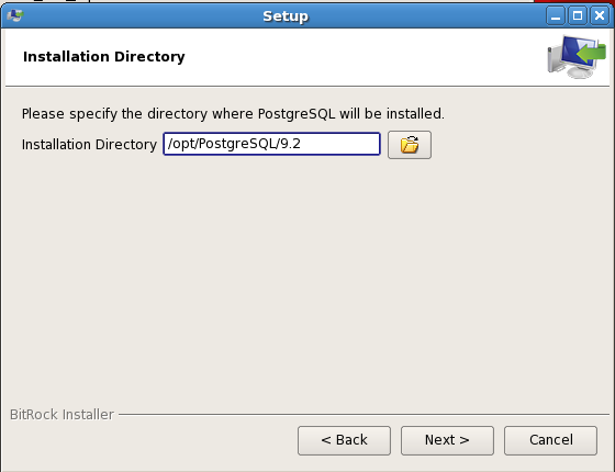

2. Installation directory
Click Next

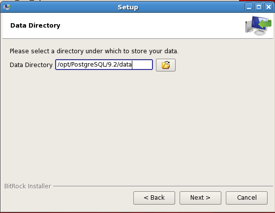

3. Data Directory
Click Next

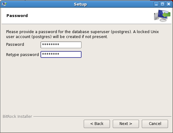

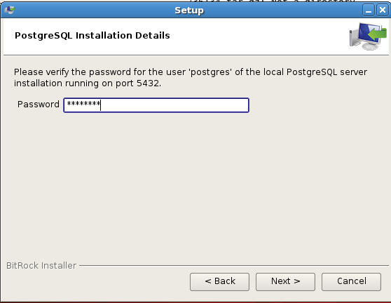

4. PostgreSQL Super User Password
Click Next

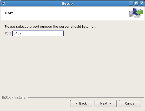

5.Port
Click Next

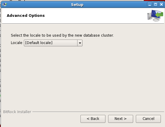

6. Locale Settings
Click Next

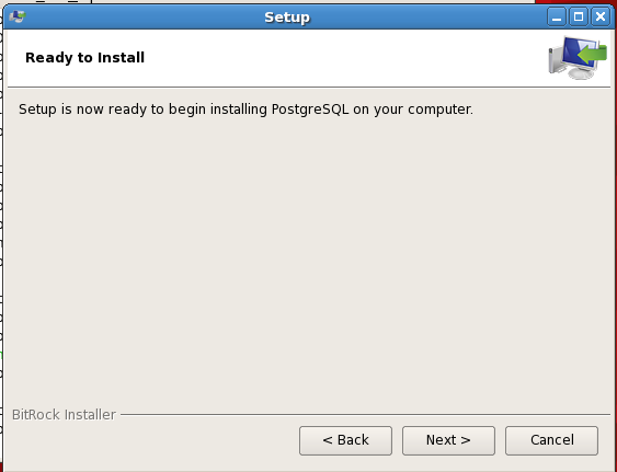

7. Ready to Install
Click Next

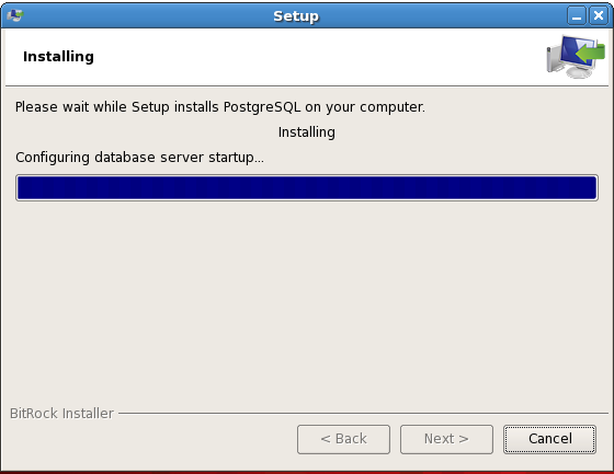

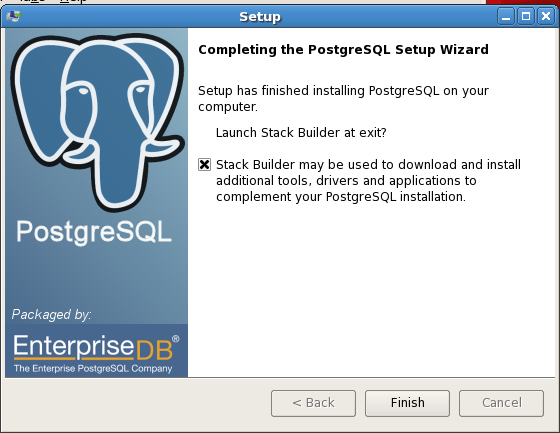

8. Installation Progress

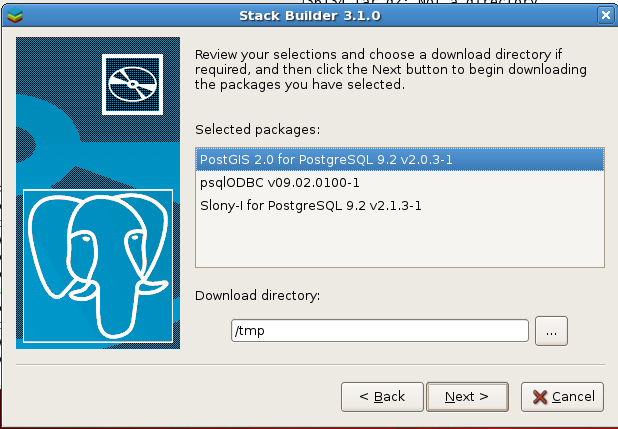

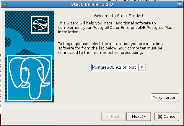

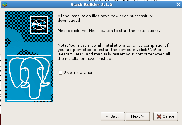

9. Stack Builder
Alternatively, you can launch the “Application Stack Builder” later by going to Applications > PostgreSQL 9.2 > Application Stack Builder.
For now Click Finish to continue installing add-ons by launching Stack Builder.
Click Next
Choose from drop down PostgreSQL 9.2 on port 5432
Click Next

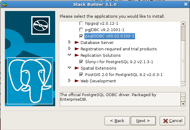

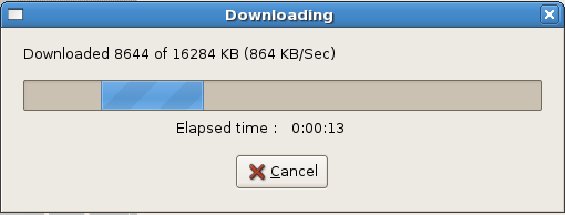

Accept default “tmp” directory. This is the location where all the downloads will be placed.
Click Next.
Wait until the downloads complete.
Click Next.

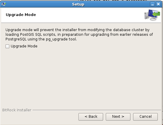

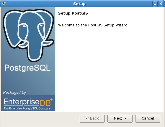

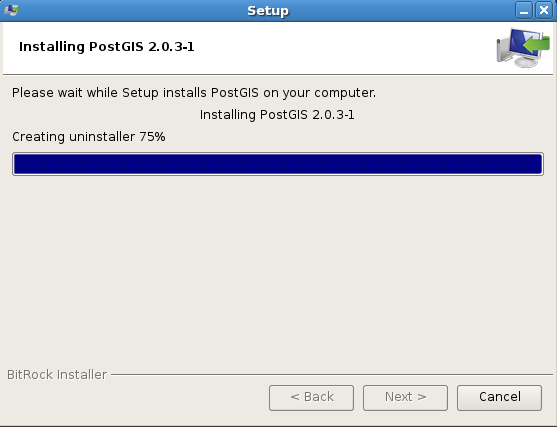

10. PostGIS 2.0 Installation (Optional)
Installation of PostGIS enables the use of PG_Geometry spatial type in addition to the Esri supported ST_Geometry geometry type.
Click Next
Click Next
11 . Database Authentication
Click Next
In the ready to Install dialog box, click Next
Wait until a template spatial database is created.
Click Finish on the PostGIS Setup Wizard.

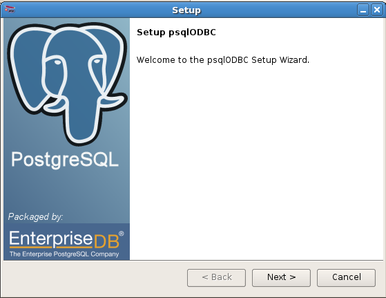

12 PSQLODBC Setup.
Follow the wizard in the installation steps enabling you installation of ODBC drivers.

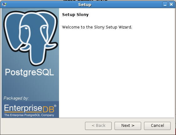

13. Setup Slony
Click Next
click Next in the Ready to Install dialog box. Follow the installation wizard until the replication tool installs successfully.

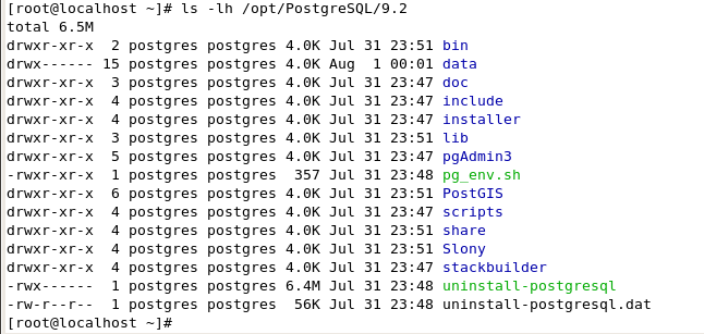

c) Change owner of home folder from root to postgres by issuing below command.
chown -R postgres.postgres /opt/PostgreSQL/9.2
Confirm rights by running by issuing command below.
ls -lh /opt/PostgreSQL/9.2

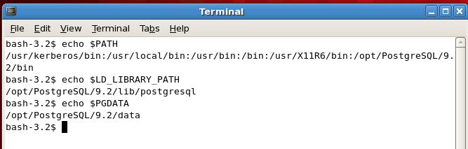

b) Log in as postgres user and test that the environment variables set previously are available.

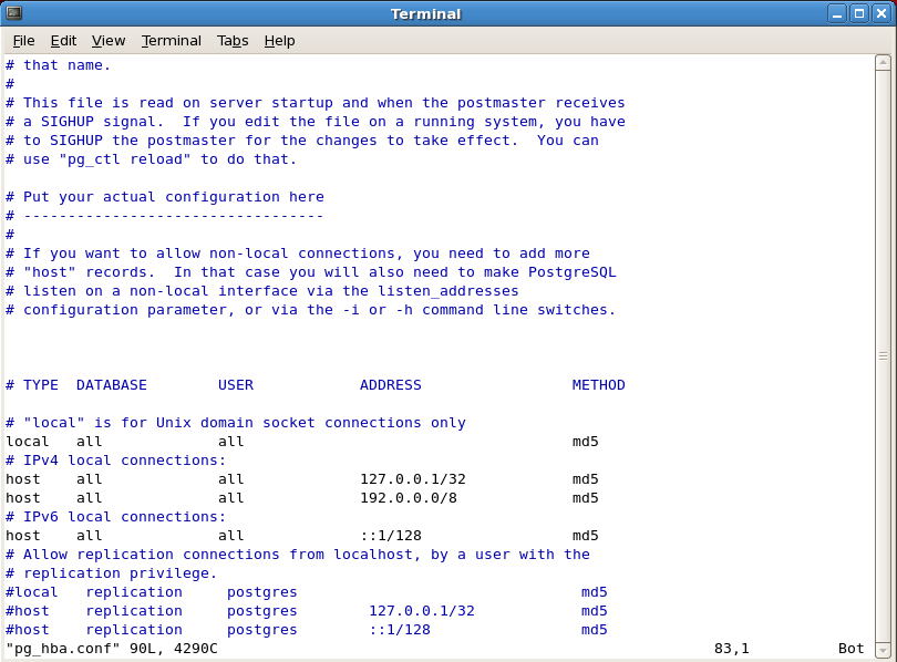

b) Alter pg_hba.conf to include IP addresses of the client machines.
1. Open a terminal.
2. Issue the below command as user postgres .Backup pg_hba.conf and postgresql.conf
cd data
vim pg_hba.conf
3. Allow all users who supply a valid password to connect to any of the databases on the PostgreSQL instance from addresses beginning with say 192, you would add a line similar to the following to the pg_hba.conf file:
host all all 192.0.0.0/8 md5
4. Exit and save vim by issuing command after pressing esc key to exit edit mode
:wq

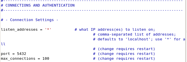

c) Confirm postgresql.conf file “Connections and Authentications” section is similar to the below entries in

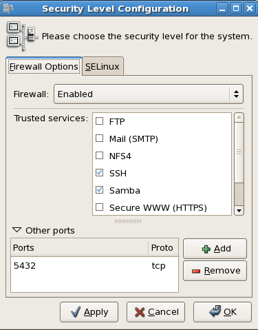

5. Security Wall and Firewall
a) Add port 5432 to the firewall of the linux distro as the root user.

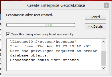

a) Run Create Enterprise Geodatabase tool in ArcToolbox > Geodatabase Administration >
Click OK
b) Process of creating an ArcSDE geodatabase. Close the dialog showing the geodatabase has been created.

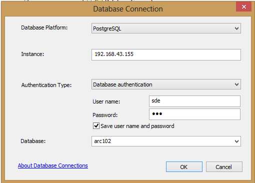

c) Create database connection.
