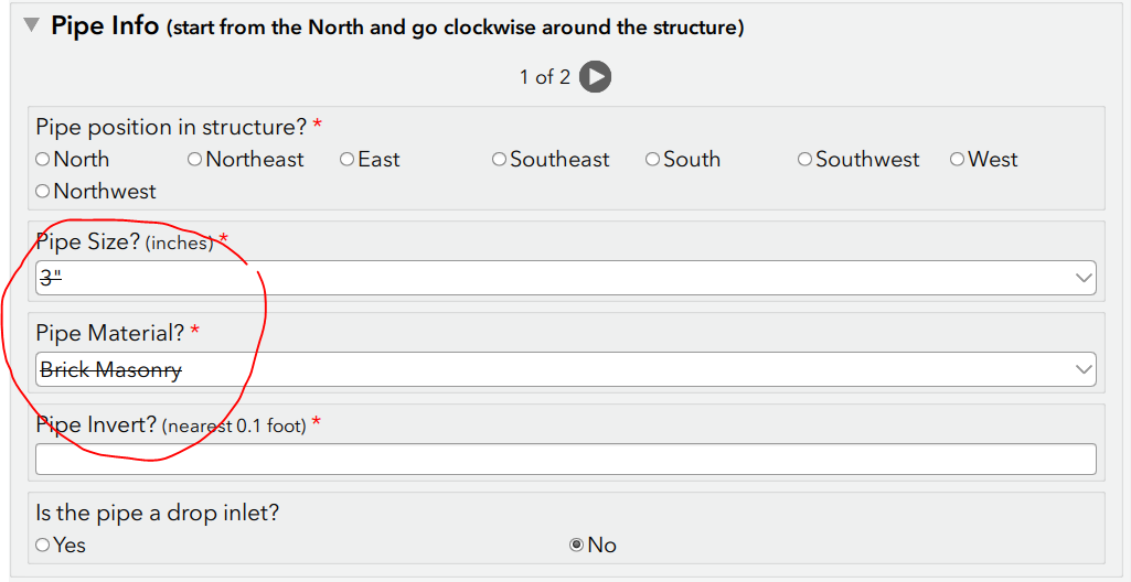

I have a simple survey form with a repeat section. When I set the repeat_count to a previous integer value input on the form ${counter} the select_one dropdowns display strike-out text once a value is selected. If I use a fixed value for the repeat_count or leave it blank and use the Add/Delete functionality of the repeat the dropdows are fine.
I also tried setting using string(${counter}) and int(${counter}) for the repeat_count with the same result. The appearance of the select_one filed are set to minimal.
Any input?
repeat_count set to ${counter} an integer field value, strikeout text displayed in dropdowns:

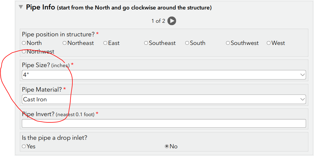

repeat_count set to fixed value of 2, normal text displayed in dropdown:
