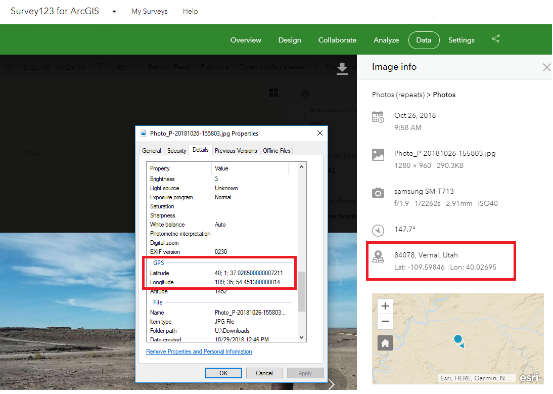

Using the code Latitude: ${Photo_P | getValue:"y"} Longitude: ${Photo_P | getValue:"x"} I added latitude and longitude values on my report for the photos and noticed that the latitude value came back negative for a northern hemisphere photo. I checked the photo properties and noticed the longitude was a positive number; as the photo georeferences correctly, there must be some data referencing that it is a west or negative value. I also noticed that the values were switched when displaying them in Survey123.
Why does my latitude come back negative on the report?
Why are the values switched in Survey123?
Values as they appear on the report
Values as they appear in Survey123 and the photo properties
