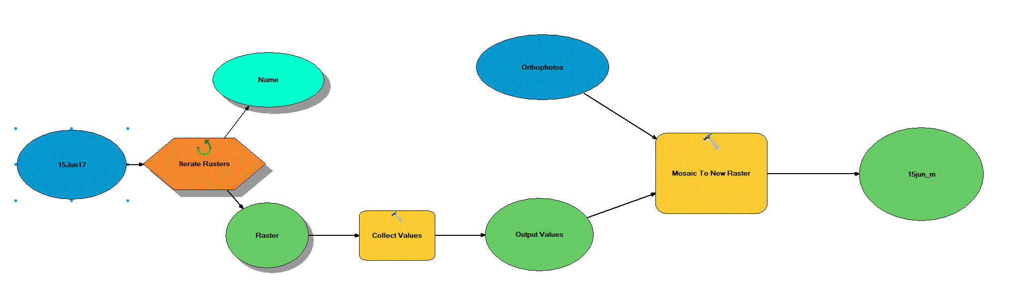

I'm trying to iterate through a folder of .sid files to perform a batch Mosaic to Raster, which l want to create a single mosaiced output. Currently, my model is set up like this:

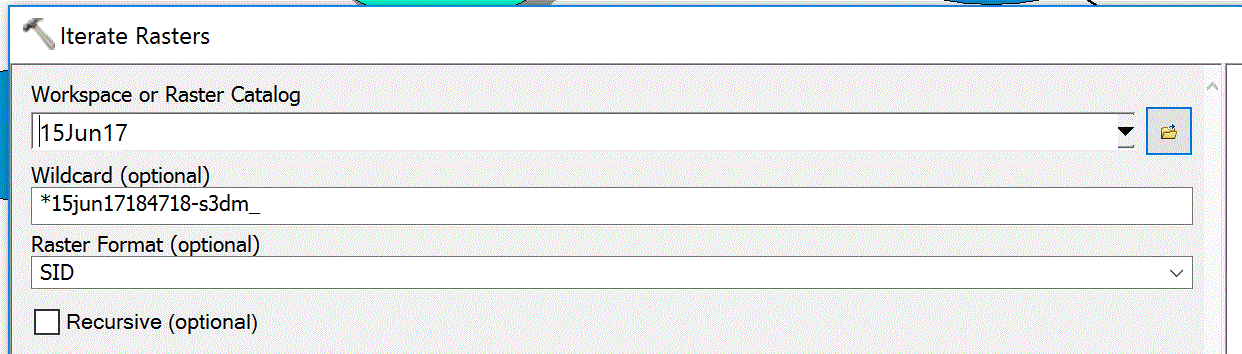

I set up the Iterate Rasters tool like this:

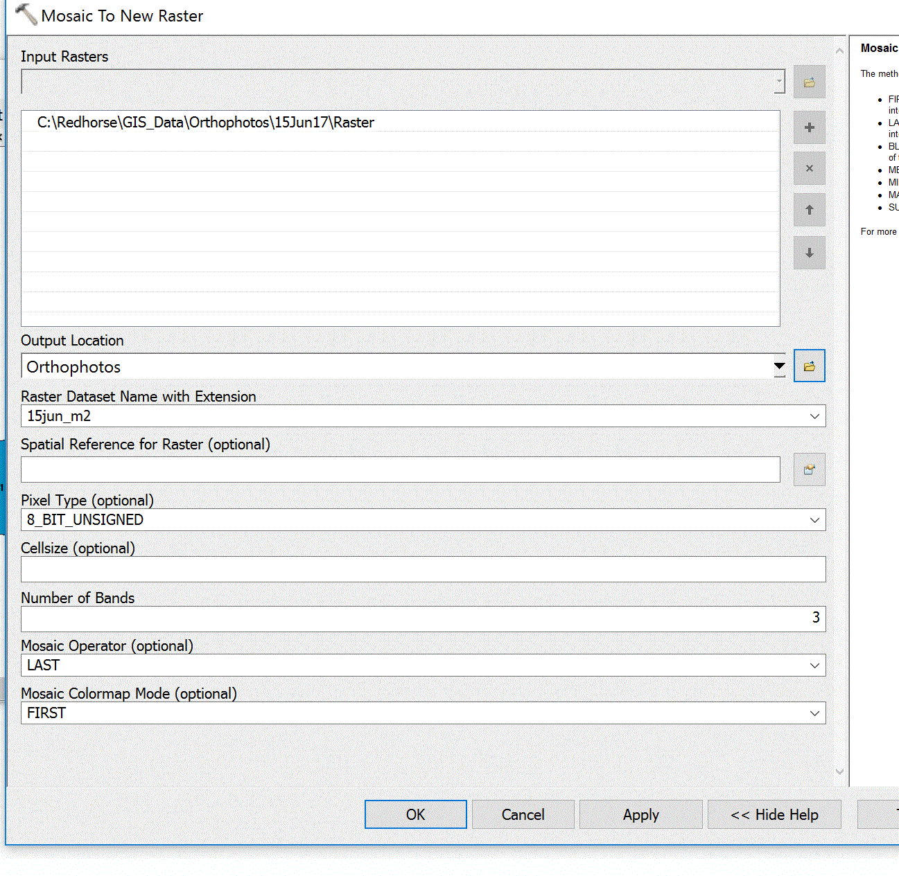

I don't believe the Wildcard option is necessary, because I selected .sid as the Raster Format. I've tried it with a wildcard and without. After that I did not have any other unusual field entries in the Mosaic to New Raster tool. This tool was set up like this:
I did not put a .tif extension on the Raster Dataset Name with Extension option because it did not seem to like the .tif extension (This could be a reason why my model is failing, but I don't really think so.)
I've tried this same model with other Iterator options (i.e. files, workspaces) and have had no success. I've also tried this same model but with out the Collect Values model tool.
The model runs and finished in about 1 second and says "Completed", but has no output.
