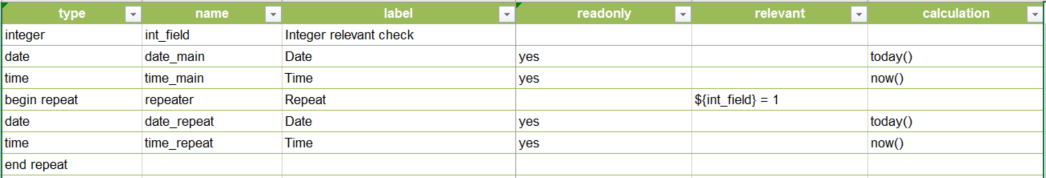

The following workflow reproduces the bug:
- Add an integer field (used in the repeat's relevant expression)
- Add a date field and a time field outside of a repeat. Default them to today() and now() respectively
- Add two similar fields inside a repeat. Default them to today() and now()
- Add a relevant expression to the repeat (integer field = 1 for example)

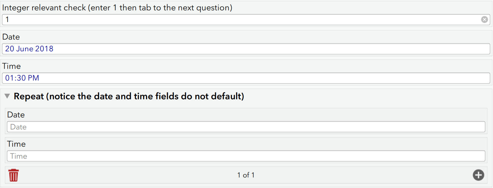

Execute the survey:
- Only the date and time fields in the main survey get’s defaulted as expected
- Date and time fields inside the "related" repeat does not get defaulted when the relevant expression is true (when 1 is entered into the integer field)
