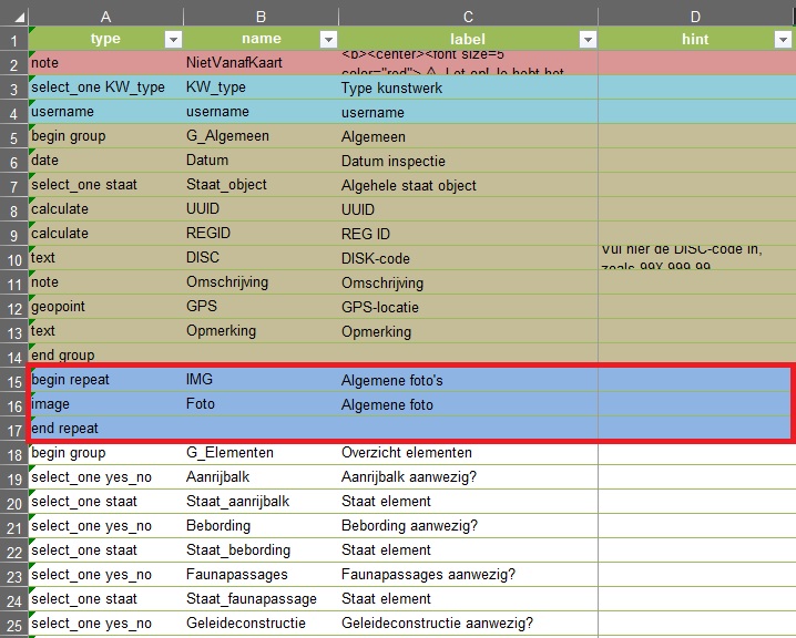

In this particular survey there are 3 different image options:
- General photos (in a repeat with only photos)
- Specific photos (in a repeat with other questions)
- Signature (not in a group nor repeat)
Specific photos and the signature work perfect, but I cannot seem to get the general photos to work. Part of the XlsForm with the general photos marked in red is shown below.

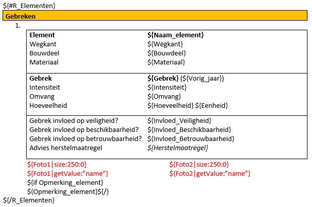

For a comparison, the specific photos, also in a repeat, are added to the template as follows. These photo tags are marked in red.

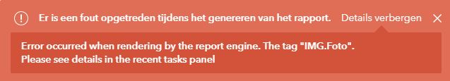

The photos "Foto1" and "Foto2" in the repeat "R_Elementen" are exported correctly. However, when I want to export the photos in "Foto" in the repeat "IMG", I get the following error:
In one of the earlier version of this survey, the export was fine, but after some changes (without changing the IMG-repeat) it started to produce this error. Any thoughts on this issue?
