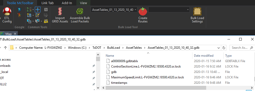

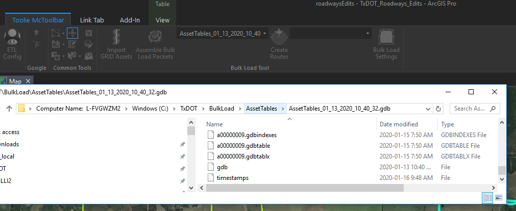

Note that if I right click and remove the tables the locks disappear:
Before:
After:

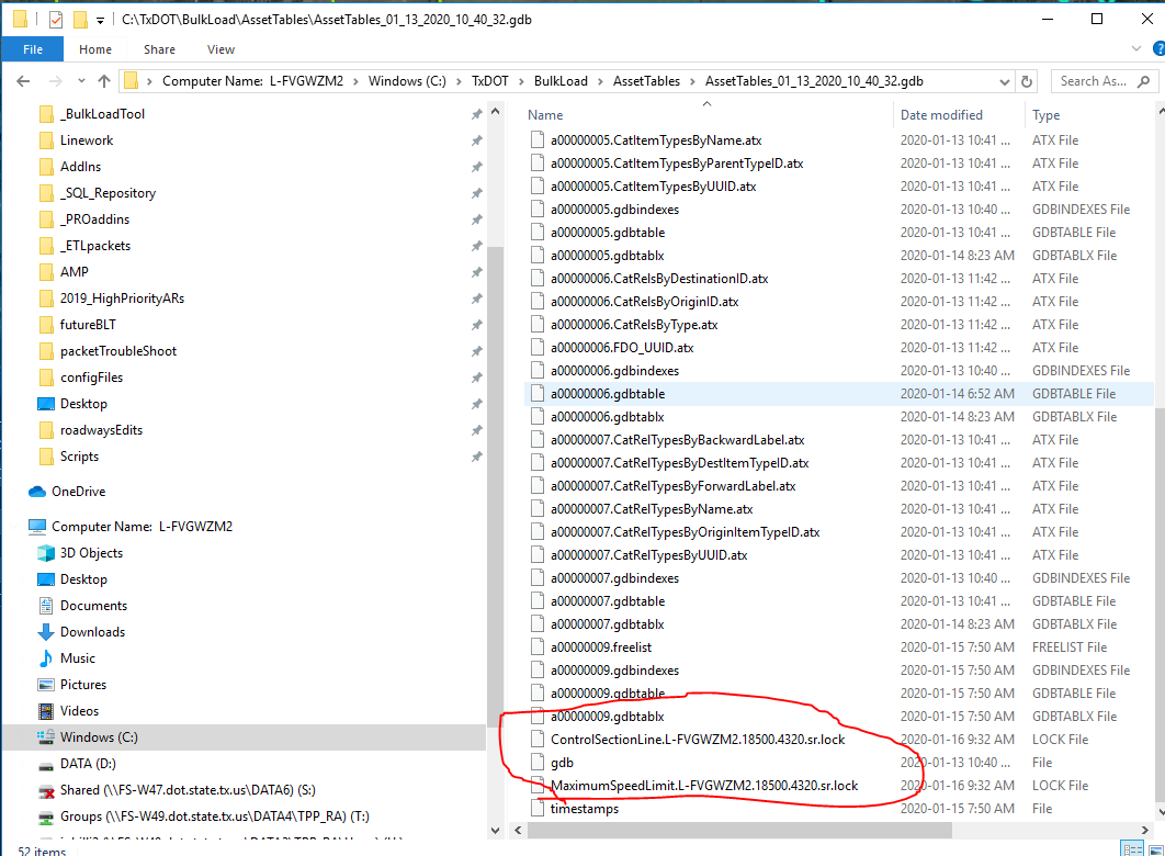

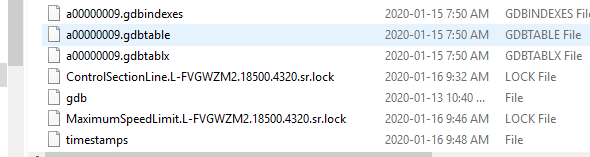

However, if I run the tool and remove the tables that way... The locks persist
Leading to this error:
The locks remain even after I click out of the Python window:

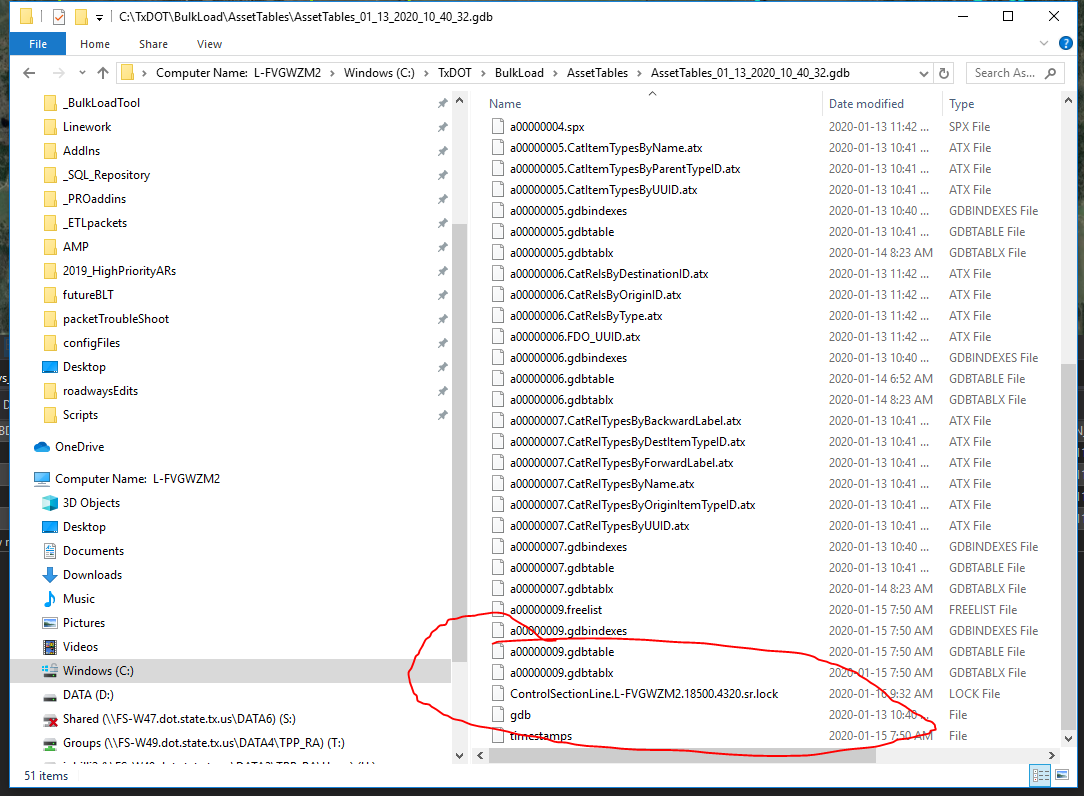

However... as soon as I click the button to run the tool again, the locks disappear:
Before:
Immediately after clicking the Import button again (locks are cleared):
