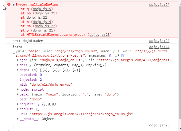

When I try that, Dev Tools scream at me:
