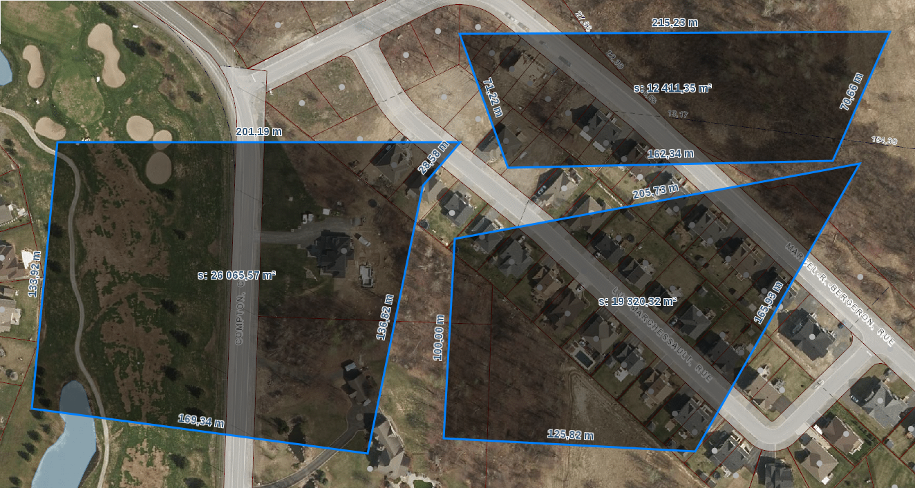

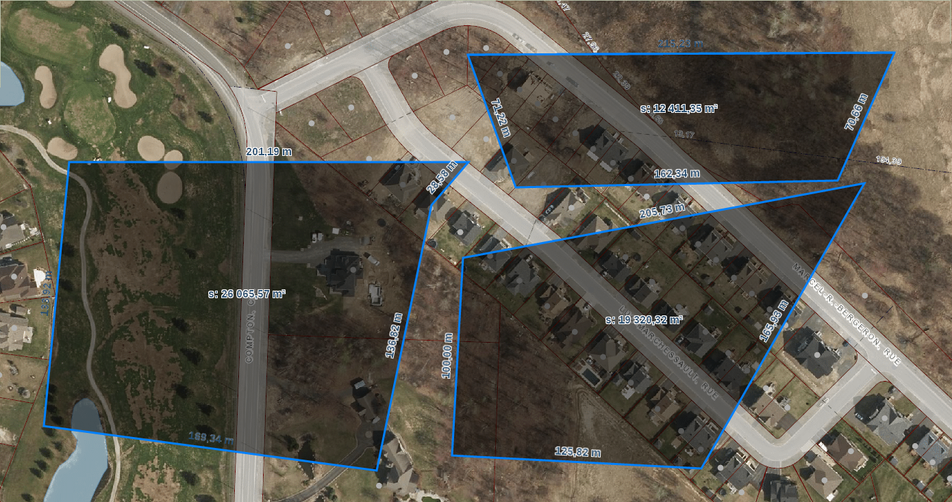

I'm having an issue with the Halo size of TextSymbols in Chrome. I haven't been able to see a pattern yet, but it happens frequently. Often the HaloSize seems to be 1 less then asked. For instance if I ask for a HaloSize of 1, some will be at 0. If I ask for a HaloSize of 2, some will be at 1. If I load the exact same graphics in Firefox, the Halos are fine.
Here's screenshots from our application. In this specific case we add TextSymbols to measure polygon segments. All properties are the same for each TextSymbol, except for the angle and actual text used. Note that the surface labels in the middle of each polygons never have this issue, only the ones along each polygon segments. In this shot there 3 symbols that lost their halo in Chrome.

We're using the API 3.19
Chrome
Firefox
