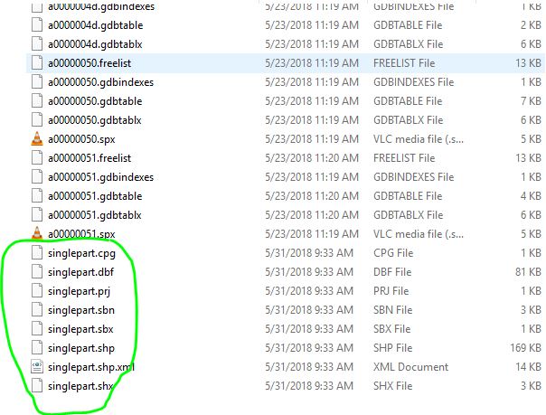

I am writing output data to the scratch geodatabase in a script - it was working great before but now it is no longer working and I'm trying to figure out if it's an IDE problem or something else. When I write data to the scratch geodatabase, it is treating it as a folder and appending ".shp" to the end of the output data instead of treating it as a file geodatabase and writing the output data as a feature class like it's supposed to. Additionally, it will run through the first tool call and write the output, but then the second tool call results in an error because it's trying to append ".shp.shp" to the output data name which is obviously invalid... I'm leaning towards this being an IDE problem because the script works great if I add the toolbox to ArcMap and run it inside there. Has anybody else seen this fishy behavior using PyCharm?

It truly does write the shapefile out into the geodatabase folder:
