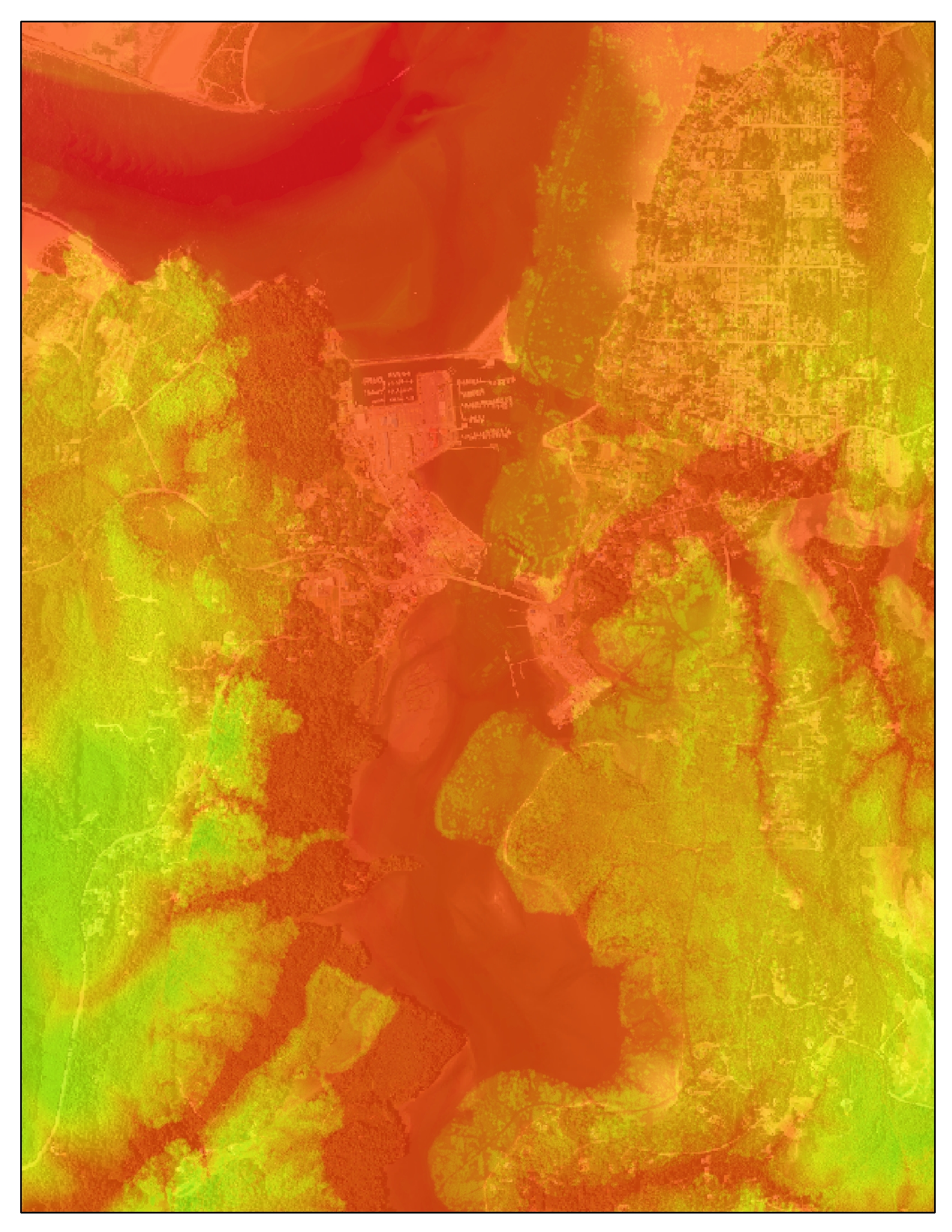

Problem: When I put it in ArcMap with a basemap in the WGS_1984_UTM_Zone_10N, it is offset. I tried estimating the offset and using the Shift tool, but it is difficult given the permanent features in a basemap with current bathymetry topography. It seemed to indicate the offset may not be quite the same everywhere. I'm not sure though.
