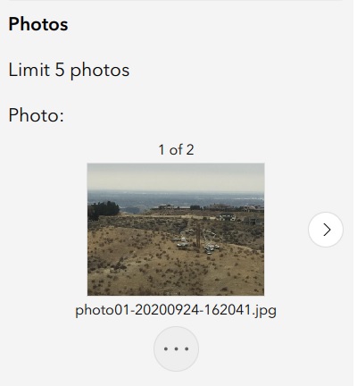

However, when the inspector opens an existing survey from the Sent box, the multiline image is not enabled. The screenshot shows no edit tools (add/remove). The 3-dot menu only allows the photo to me moved:
Is there a setting where I can override this default behavior? Or is this just how Survey123 works.
