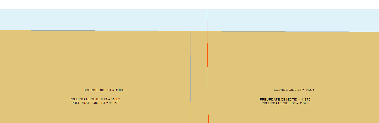

The features shown below that are semi-transparent blue with red outlines have the source geometry I want to transfer and features that are orange with grey outlines are the features I want to change before I have done any update.

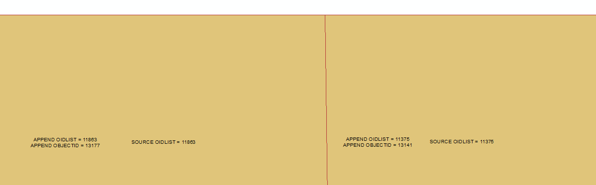

The features shown below are the result of deleting the original features and using the Append tool. The geometry matches exactly, but the ObjectIDs have changed.

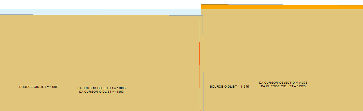

The features shown below are the result of using a da.UpdateCursor to transfer the geometry. The ObjectIDs have not changed and the geometries have changed, but the transferred geometries are not identical to the source geometry.
Has anyone else experienced this and come up with a solution that both preserves the original OBJECTIDs and correctly transfers geometry that is identical with the source geometry?
Here is one of the scripts I tried. The script completes without error and the geometry of the updated feature class is being changed, but the output geometry is not identical to the source geometry as shown above.
