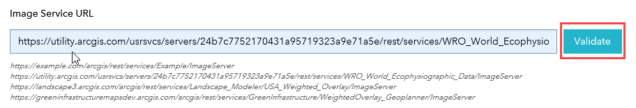

- In the Configure Suitability Modeler dialog, click the Validate button. This will make sure that you can access the World Ecophysiographic service hosted by Esri. Click OK.

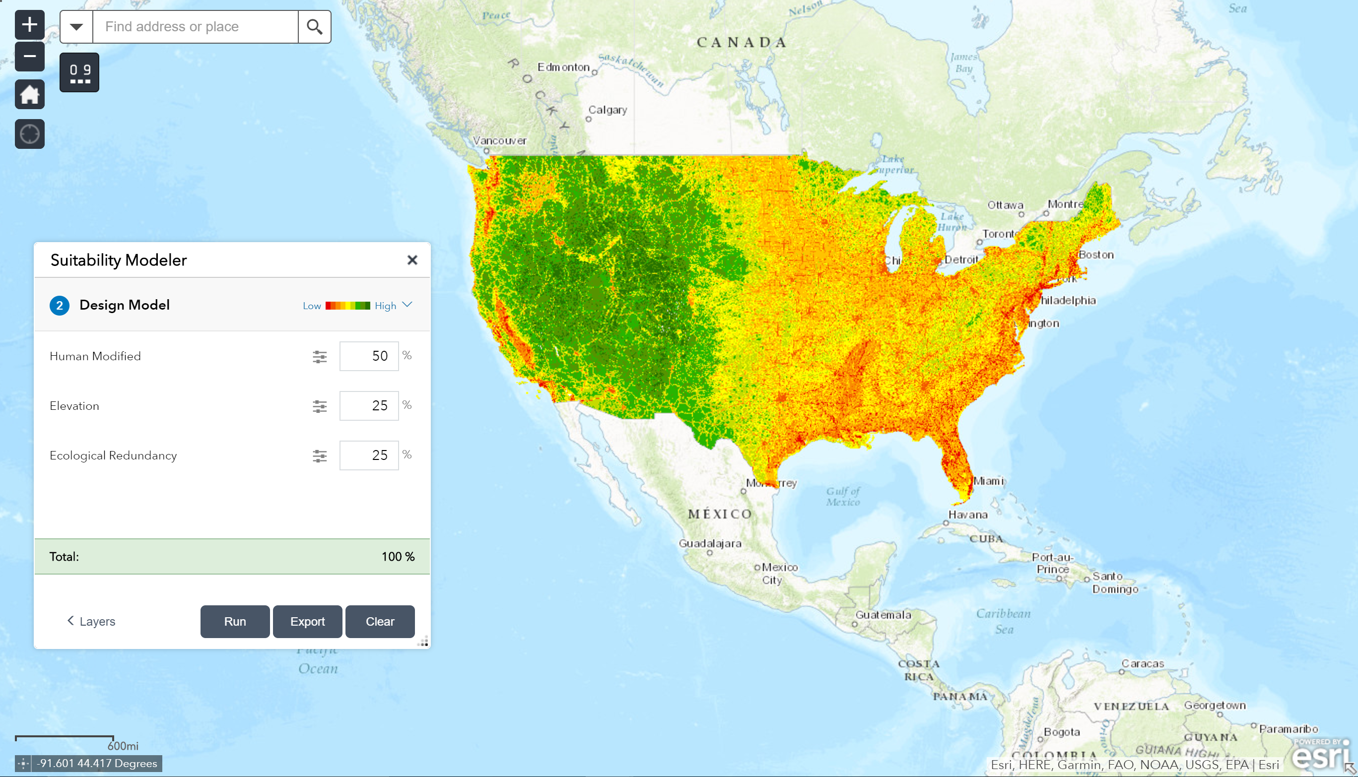

- In the Select Layers list, check on Distance to Water and Population.
Click Design Model to move to the Design Model screen.
- In this screen, you type in percentages for each layer. This allows you specify an importance for each layer in the analysis.
- Type in 50% for both layers. If you want, click the slider icons to examine and adjust the class values for each layer.
Click Run.

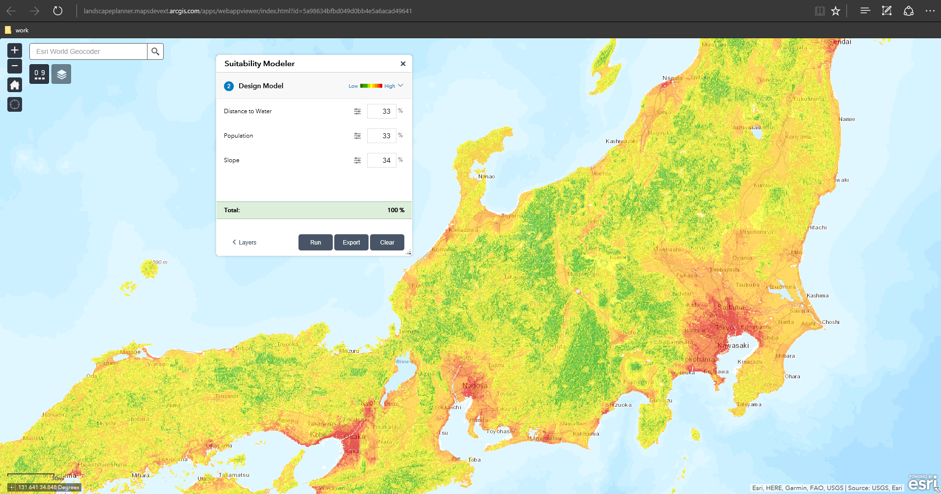

You’ve just created a model of population and distance to water! Shades of red represent high densities of people close to bodies of water like oceans, lakes and rivers. Shades of green represent lower densities of people living far from water bodies. Zoom to Tokyo and you’ll get a vivid picture of what this model communicates.
