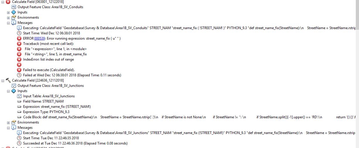

I am trying to write a field calculation script that changes road names with abbreviations to the full name. Example: Day Dr. => DAY DRIVE or Phillips Rd. => PHILLIPS ROAD. I wrote and tested the function in Jupyter notebook and everything works fine. I got the script to work on my points feature class but the same script will not work on the same field in my line feature class. Any suggestions?
