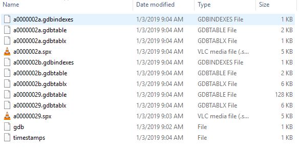

I have created a script where at the end of it, I transfer records from and FGDB to a SDE database. I use the editor and believe I stop the operations correctly. At the end of this process, there are no longer any lock files in my FGDB. When I go to delete the entire FGDB, it gets hung up on .gdbtable and the deletion process will stop (and I assume if that got fixed, it would get hung up on .gdbindexes, .gdbtablx, or .spx).
I have tried compacting the database and this does not work. I have tested that I can obtain a schema lock on one of the feature classes inside the FGDB and it says I can, I think this indicates that exclusive locks are not present. When I look in file explorer, there are no locks present. I really need an arcpy solution to this problem so the FGDB deletes successfully.
This is my code, starting at the editor process. Before this piece of code, I use search cursors on the FGDB with the with/as notation (so cursor locks should be deleted automatically).

These are the files that are left after I attempt to delete the FGDB (ignore the "VLC media file" - it's just Windows assuming it knows what program to open .spx files in)
