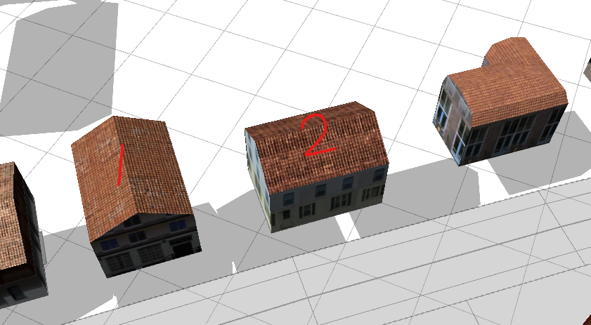

Hello all, I'm trying to map an European town with many sloped roofs in City Engine. The rule I use is the default one: Building_from_OpenStreetMap.cga. The roof ridge generated for buildings seems like always along the building's longest side, however I wonder if there is a way to control the roof orientation. For example, In the picture below, how to make roof 1 run the same direction as roof 2?
I have manually run "Set to first edge" and "Compute first/street edge" tools for this building, but the roof doesn't change at all. (I set the edge computing to the shortest side but it doesn't work). Any suggestion could be helpful cuz I'm still new to this. My CityEngine version is 2019.0.
