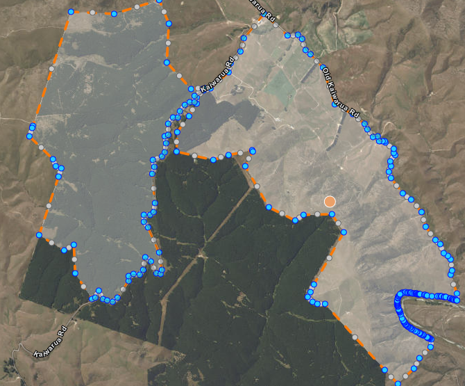

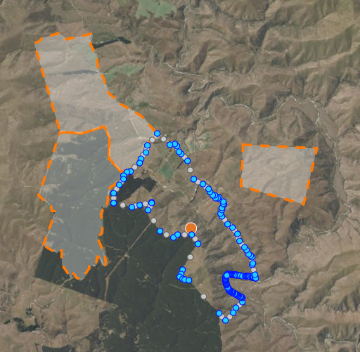

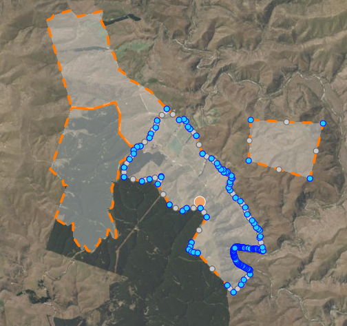

My polygon vertices remain when i remove graphics.
My polygons come from db, as well i created new polygons on the spot.
While one of many polygon coming from db always stay editable and one of new polygon created always remain editablle.
the one editable polygon always leave its vertices on removal, even when i used sketchViewModel.complete();
