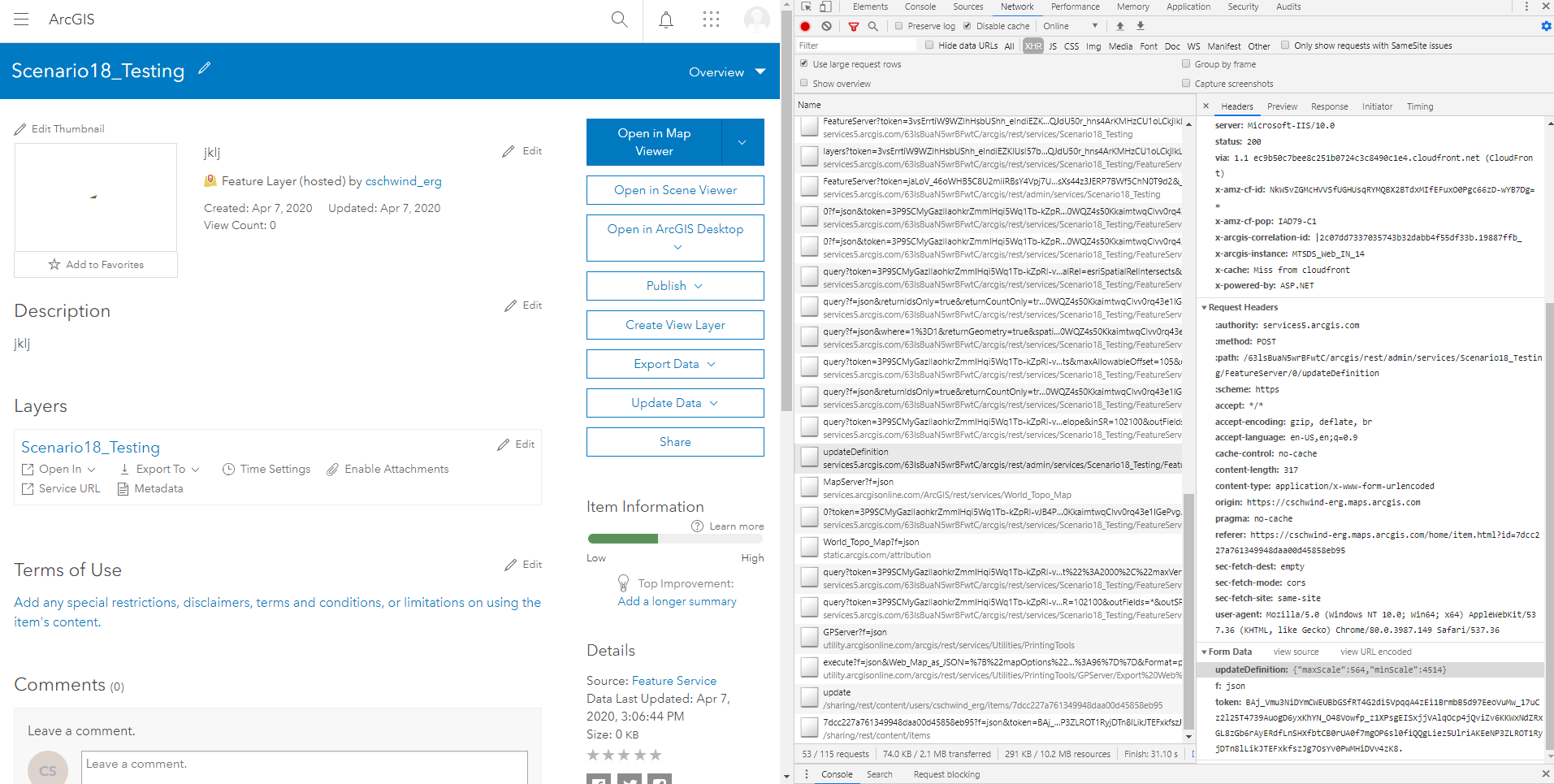

If I navigate to the layer through ArcGIS Online, the minScale and maxScale get overwritten. The screenshot below shows that an updateDefinition call is being made on my layer, which sets the maxScale to 564 and the minScale to 4514.
