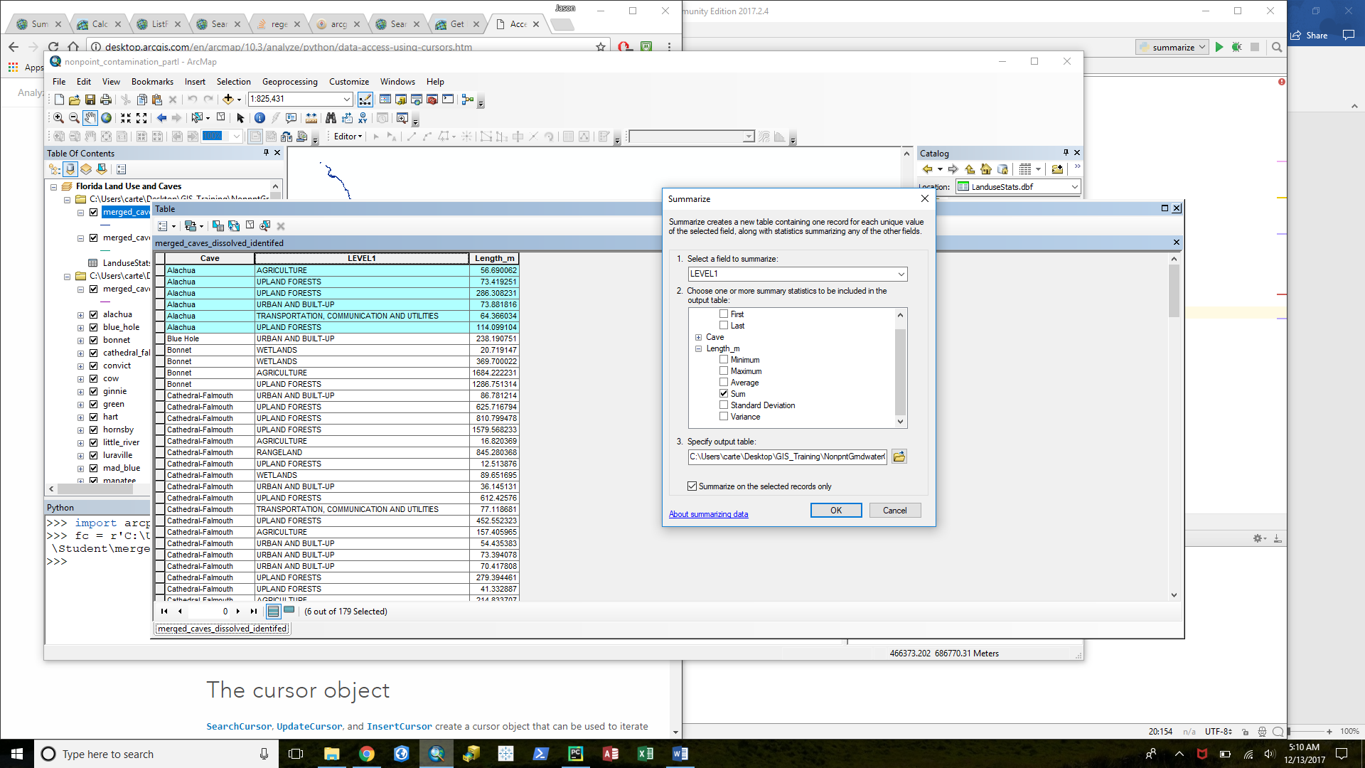

I'm working on tutorial data that has a table structured as shown in the photo below. The tutorial is asking that I summarize the length of each Cave (selected feature) in each Landuse manually using the Summarize tool from the Attributes Table and create a separate table.dbf for each Cave. I'm trying to do this in Python and I'm running into an error. Also, I could be taking the wrong approach. Any advice much appreciated. Thank you!
Here is the table:
Here is my code:
