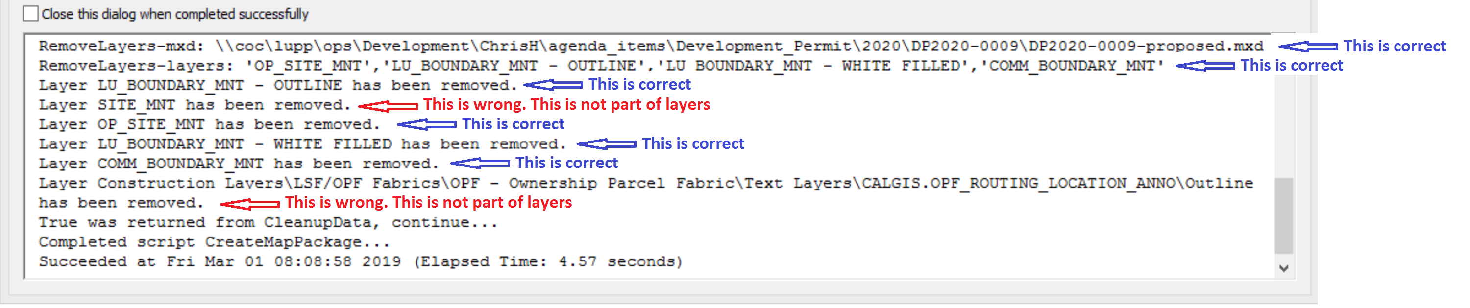

What I see as output is:
Any ideas as to why these 2 layers in red are also being removed, what am I missing?
