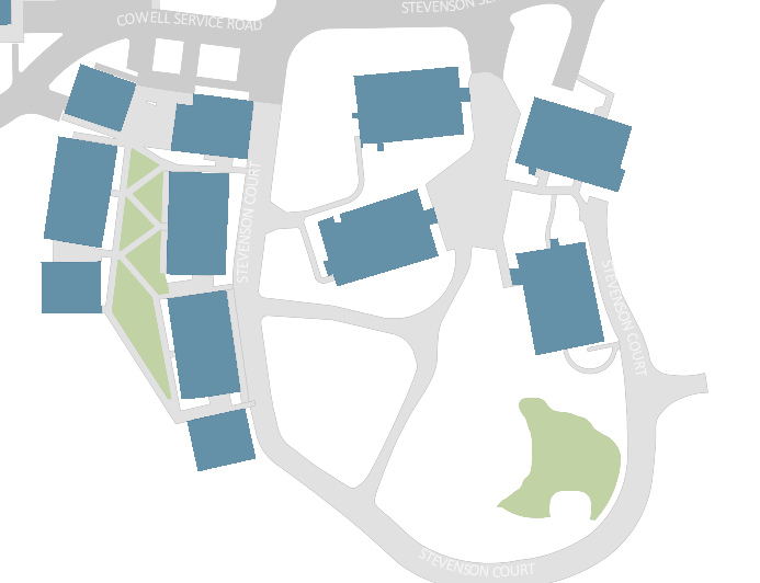

I am trying to simply add a building 'highlight' and change the cursor to pointer on hover. I don't want to change the fill inside the building like in the example below. I just want to add a highlight outline.
QUESTIONS
- Any idea what may be causing my feature layer to 're-render' on hover?
- all other features in the layer turn off then on again during the unique value renderer change that is triggered by the hover event
- I'm hoping to avoid the 'blinking' effect. Just want to change the unique value renderer on the building that was hovered over without adjusting the rest of the layer symbology
- something like, "if hittest returns an item in the buildings layer, add a graphic on top of the existing layer with custom symbology without reloading the entire layer"
- How can I get the cursor to change to the pointer on the polygon fill as well? Currently, the arrow only changes to pointer when it is over the building outline.
- This might be due to my custom symbology
