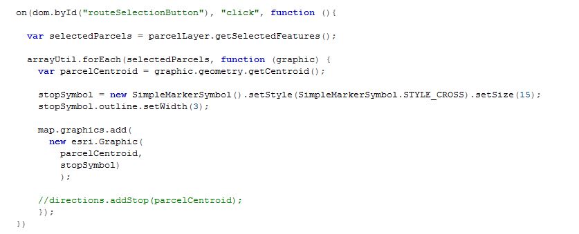

Here's the function that runs after the user has already selected their property boundaries (wired to a button click):

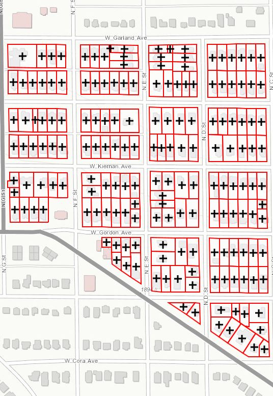

When selecting parcels while zoomed-out, centroids look correct, but selection graphics become triangles:

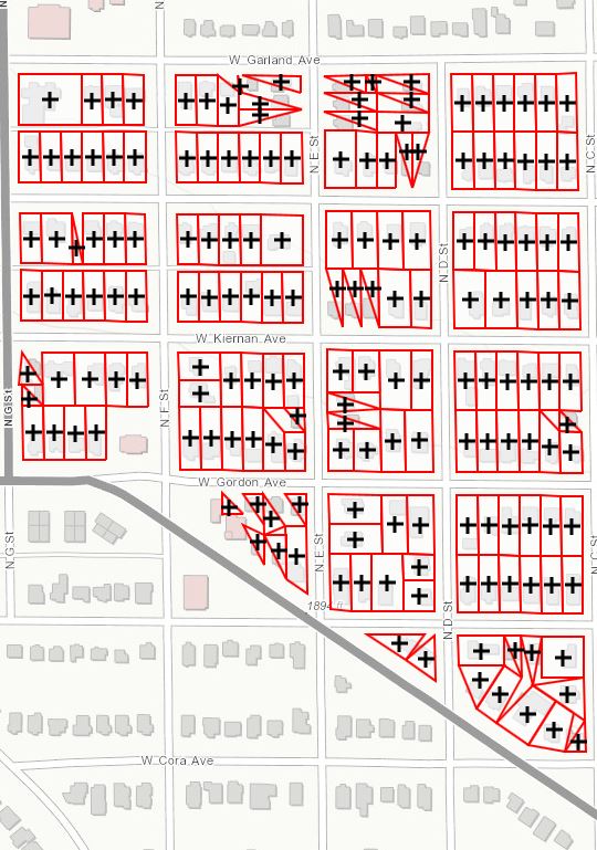

Mid-zoom selection produces these results, which appear correctly:

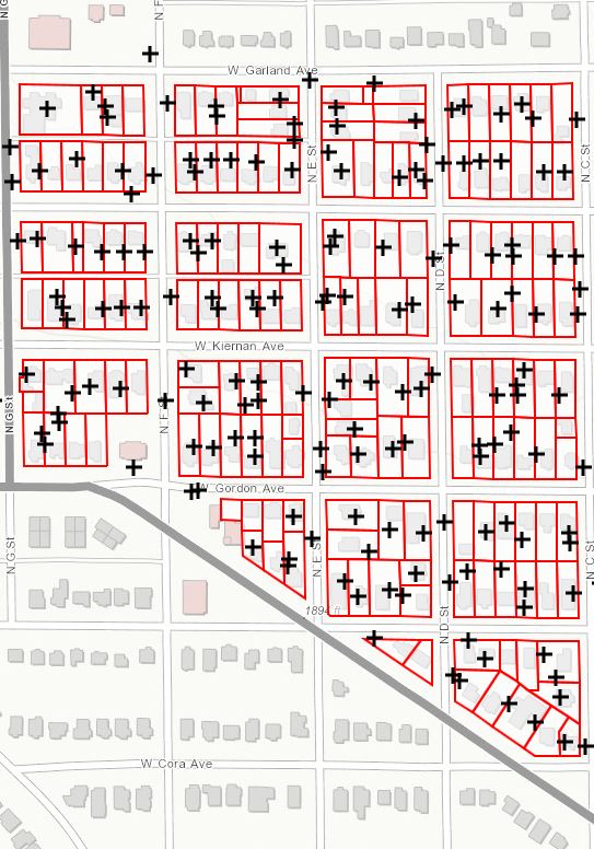

When selecting while zoomed-in closely, I get wildly inaccurate centroids.
