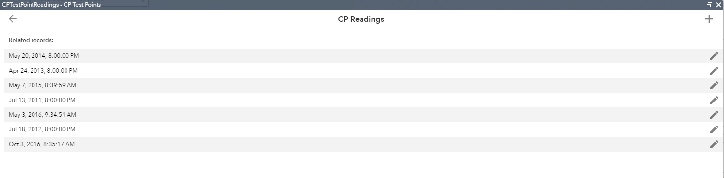

I set up in ArcGIS online a webmap that has a feature class and a single related table. Under the configure pop-up i checked show related records and under sort options i set up the sort based on a date field. Now when I open this map in Collector on the ipad it functions properly, showing the related records in descending order by date.
But when I use web app builder to set up the the editor widget it does not honor the sorting based on the web map it is created off of. Is there another way to sort this data in web app builder?
