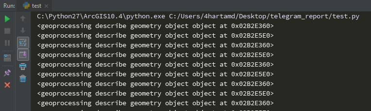

So, first of all I want you to notice that the feature class Roads has a POLYLINE geometry type, and there are no multipart features in it.
<SPAN class="keyword token">import</SPAN> arcpy
<SPAN class="keyword token">for</SPAN> i <SPAN class="keyword token">in</SPAN> arcpy<SPAN class="punctuation token">.</SPAN>da<SPAN class="punctuation token">.</SPAN>SearchCursor<SPAN class="punctuation token">(</SPAN>r<SPAN class="string token">'C:\Users\...\Administrative_area.gdb\Roads'</SPAN><SPAN class="punctuation token">,</SPAN> <SPAN class="punctuation token">[</SPAN><SPAN class="string token">"SHAPE@"</SPAN><SPAN class="punctuation token">]</SPAN><SPAN class="punctuation token">)</SPAN><SPAN class="punctuation token">:</SPAN>
<SPAN class="keyword token">print</SPAN><SPAN class="punctuation token">(</SPAN>i<SPAN class="punctuation token">[</SPAN><SPAN class="number token">0</SPAN><SPAN class="punctuation token">]</SPAN><SPAN class="punctuation token">)</SPAN><SPAN class="line-numbers-rows"><SPAN></SPAN><SPAN></SPAN><SPAN></SPAN><SPAN></SPAN></SPAN>
Normally, the output for this code will be something like this:
And it works.

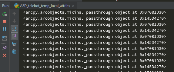

Now the problem appears when I put this little piece of code in the main script:
<SPAN class="keyword token">def</SPAN> <SPAN class="token function">get_near_data</SPAN><SPAN class="punctuation token">(</SPAN>self<SPAN class="punctuation token">)</SPAN><SPAN class="punctuation token">:</SPAN>
<SPAN class="keyword token">with</SPAN> arcpy<SPAN class="punctuation token">.</SPAN>da<SPAN class="punctuation token">.</SPAN>SearchCursor<SPAN class="punctuation token">(</SPAN>r<SPAN class="string token">'C:\Users\...\Administrative_area.gdb\Roads'</SPAN><SPAN class="punctuation token">,</SPAN> <SPAN class="punctuation token">[</SPAN><SPAN class="string token">"SHAPE@"</SPAN><SPAN class="punctuation token">]</SPAN><SPAN class="punctuation token">)</SPAN> <SPAN class="keyword token">as</SPAN> reader<SPAN class="punctuation token">:</SPAN>
<SPAN class="keyword token">for</SPAN> f <SPAN class="keyword token">in</SPAN> reader<SPAN class="punctuation token">:</SPAN>
<SPAN class="keyword token">print</SPAN><SPAN class="punctuation token">(</SPAN>f<SPAN class="punctuation token">[</SPAN><SPAN class="number token">0</SPAN><SPAN class="punctuation token">]</SPAN><SPAN class="punctuation token">)</SPAN><SPAN class="line-numbers-rows"><SPAN></SPAN><SPAN></SPAN><SPAN></SPAN><SPAN></SPAN></SPAN>
And the output is not the same as in the first case. This is not geometry.

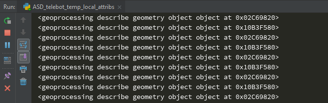

And the output is going to be like this:
So, what is going on here? Why geometries of polyline feature classes aren't returned while geometries of polygons are?
