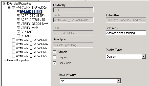

From the Workflow Manager Administrator, the Job Type, Extended Properties settings:

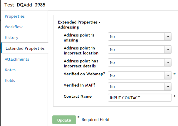

From the Workflow Manager viewer, Extended Properties before update:

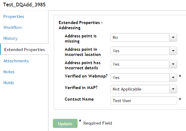

From the Workflow Manager viewer, Extended Properties after update. Details are completed and "Update" is clicked:

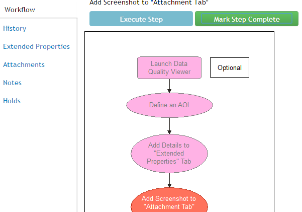

Click off of the Extended Properties tab (back onto Workflow tab)

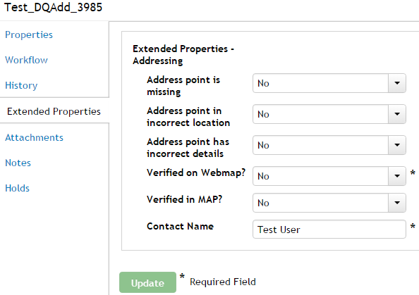

Click back onto the Extended Properties tab and all of the details as entered above are replaced by the default values (with the exception of the "Contact Name":
The value within the Extended Properties table within Oracle reflect the same information as above:
