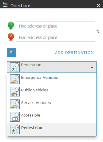

In ArcGIS Web Appbuilder Developer Edition, the Travel Modes options within the Directions widget does not show up when using a custom network analysis service. However the same Directions widget in ArcGIS Portal do not have this problem
Background:
Initially I was creating a web map using Web Appbuilder in Portal. The web map used the Directions widget on a custom Network Analysis Service that contains different travel mode options. In Web Appbuilder for Portal everything works fine. I only had to put in the Network Analysis Service link in the Route URL box while leaving the Travel Modes URL blank, and the Travel Mode options automatically appear on the Directions widget.
Directions Widget with travel modes.
