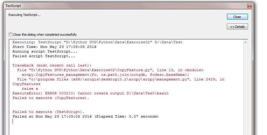

Hi All
As suggestions given in the blog i modified the script, But still i am getting the same error please help me
when i run the script in python editor with workspaces hardcoded like below, the code executes properly.
import arcpy
... import os
... from arcpy import env
... env.overwriteOutput = True
... env.workspace = "D:/Python DVD/Python/Data/Exercise02"
... outgdb = "D:/Data/Test1.gdb"
... print outgdb
... fclist = arcpy.ListFeatureClasses()
... for fc in fclist:
... fcdesc = arcpy.Describe(fc)
print fcdesc.baseName
print os.path.join(outgdb, fcdesc.baseName)
... arcpy.CopyFeatures_management(fc, os.path.join(outgdb, fcdesc.baseName))

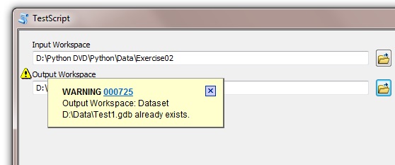

But when i create custom tool using this script i am getting the error
import arcpy
import os
env.workspace = arcpy.GetParameterAsText(0)
outgdb = arcpy.GetParameterAsText(1)
print outgdb
for fc in fclist:
Error is:
