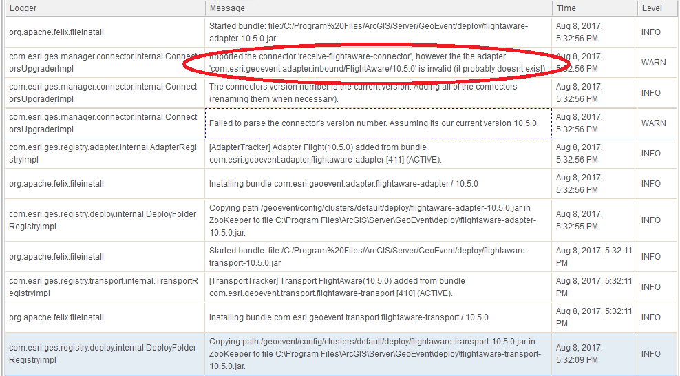

but after following the steps indicated in the manual for setting the configuration and registering the adapter I notice in the log this warning:

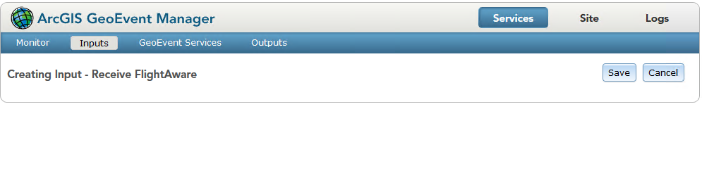

and if I try to create an input the page doesn't load anything but the save and cancel buttons

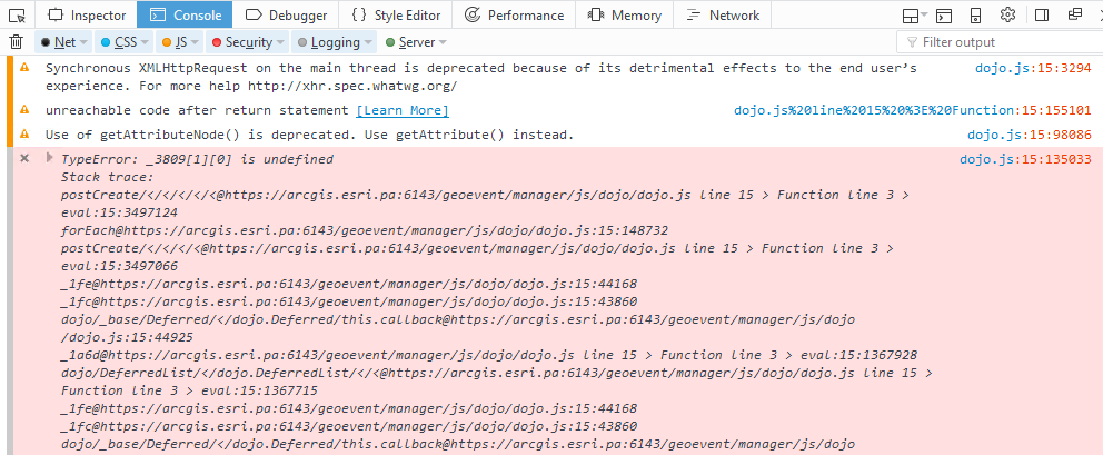

If I inspect the Web Browser Dev tools I see this:
