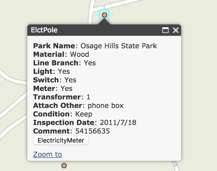

I appreciate your time in advance. I want to create a button inside the infoWindow (Popup). Ideally, users click the button('ElectricityMeter'), which calls the Ajax and display the JSON data in the Dialog (JQuery) on the map. The codes below are the snippet of my codes. It would be appreciated if you all could provide your opinions.
The workflow:
First: the new Popup, okMap is the object and the 'infoContainer' is the 'id ' for the infoWindow

<SPAN class="keyword token">else</SPAN> <SPAN class="keyword token">if</SPAN> <SPAN class="punctuation token">(</SPAN>feature<SPAN class="punctuation token">.</SPAN>layerName <SPAN class="operator token">===</SPAN> <SPAN class="string token">"ElctPole"</SPAN><SPAN class="punctuation token">)</SPAN> <SPAN class="punctuation token">{</SPAN>
feature<SPAN class="punctuation token">.</SPAN>feature<SPAN class="punctuation token">.</SPAN><SPAN class="token function">setInfoTemplate</SPAN><SPAN class="punctuation token">(</SPAN><SPAN class="keyword token">new</SPAN> <SPAN class="token class-name">InfoTemplate</SPAN><SPAN class="punctuation token">(</SPAN>feature<SPAN class="punctuation token">.</SPAN>layerName<SPAN class="punctuation token">,</SPAN>
<SPAN class="string token">"<b>Park Name</b>: ${Park_Name}<br>"</SPAN> <SPAN class="operator token">+</SPAN>
<SPAN class="string token">"<b>Material</b>: ${Material}<br>"</SPAN> <SPAN class="operator token">+</SPAN>
<SPAN class="string token">"<b>Line Branch</b>: ${LnBranch}<br>"</SPAN> <SPAN class="operator token">+</SPAN>
<SPAN class="string token">"<b>Light</b>: ${Light}<br>"</SPAN> <SPAN class="operator token">+</SPAN>
<SPAN class="string token">"<b>Switch</b>: ${Switch}<br>"</SPAN> <SPAN class="operator token">+</SPAN>
<SPAN class="string token">"<b>Meter</b>: ${Meter}<br>"</SPAN> <SPAN class="operator token">+</SPAN>
<SPAN class="string token">"<b>Transformer</b>: ${Transfmer}<br>"</SPAN> <SPAN class="operator token">+</SPAN>
<SPAN class="string token">"<b>Attach Other</b>: ${OthrAttach}<br>"</SPAN> <SPAN class="operator token">+</SPAN>
<SPAN class="string token">"<b>Condition</b>: ${Condition}<br>"</SPAN><SPAN class="operator token">+</SPAN>
<SPAN class="string token">"<b>Inspection Date</b>: ${InspctDtt}<br>"</SPAN> <SPAN class="operator token">+</SPAN>
<SPAN class="string token">"<b>Comment</b>: ${Comment}<br>"</SPAN><SPAN class="operator token">+</SPAN>
<SPAN class="string token">"<button id='btnElectricityMeter'>ElectricityMeter</button>"</SPAN>
<SPAN class="punctuation token">)</SPAN><SPAN class="punctuation token">)</SPAN><SPAN class="punctuation token">;</SPAN>
