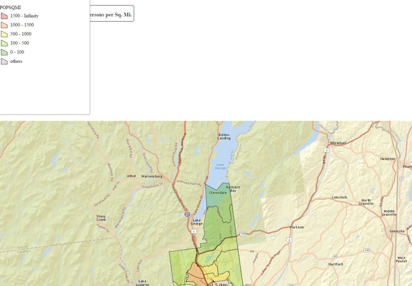

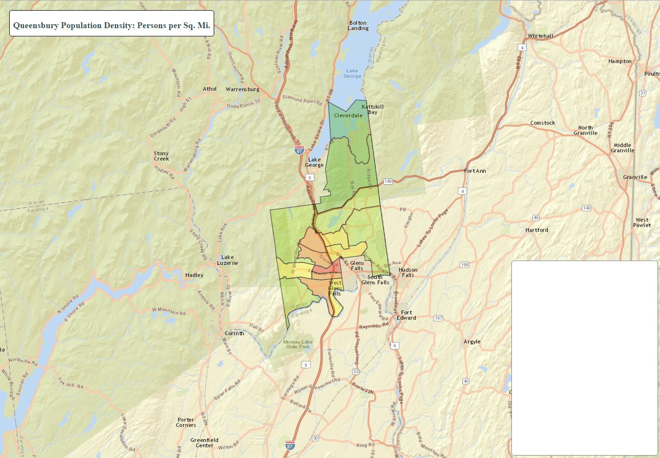

I am working on trying to display a featurelayer with a legend in a simple map. The html page contains a map, a title block and a div to hold the legend which all display correctly. The problem is when I add the code to include the legend, the legend is added to the map, but not in the div in the position as was set up with css. I've attached the code along with two images showing the map (before) as designed and (after) as it appears when adding the legend.
Any help is appreciated.
George Hilton
Town of Queensbury, NY
BEFORE IMAGE:
AFTER IMAGE:
