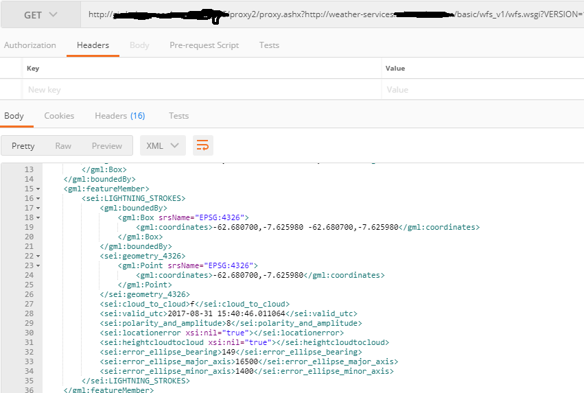

- Modified the .NET proxy provided by ESRI to add the needed auth header (see proxy page code at bottom of post)
- Tested the proxy to make sure requests were going through with the auth header, this was successful:

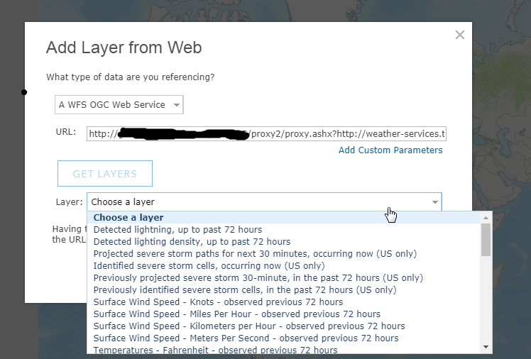

- Tried to add a "layer from the web" in an AGOL WebMap, with the proxy url in front of the actual WFS url.
- This part works, as it will set the request parameter to
GetCapabilities, which returns a valid list of layers available in the WFS service. Awesome!

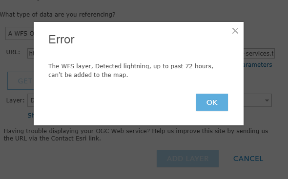

- But here is where things break down...Once I choose a layer from the drop down, AGOL must have some internal validation which strips out my proxy and substitutes it with the default
myorg.maps.arcgis.com/sharing/proxy that AGOL uses. Obviously, I get an error here because that proxy doesn't know to add my auth header:
By using Fiddler, I was able to see that ArcGIS Online is no longer using my proxy (the two calls above the highlighted one were used by AGOL to generate the layer list and these calls used the proxy):
