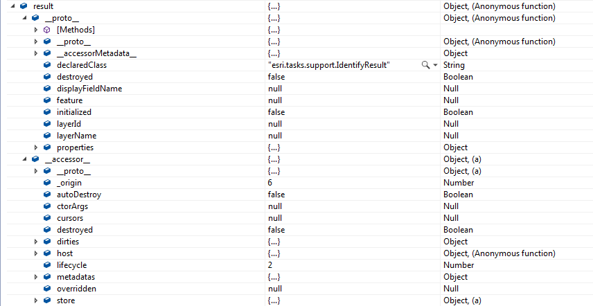

I want to access the feature geometry when using the IdentifyTask in the JavaScript API 4.6 so that I can add a graphic to my point feature.
I am using the Sample located at https://developers.arcgis.com/javascript/latest/sample-code/tasks-identify/
I added a line
var mp = result.feature.geometry;
but the geometry is null.
Here is part of the code:

Here is what the result object looks like in 4.6. How do I find the geometry? The "_proto_" and "_accessor_" make it difficult to find anything.
