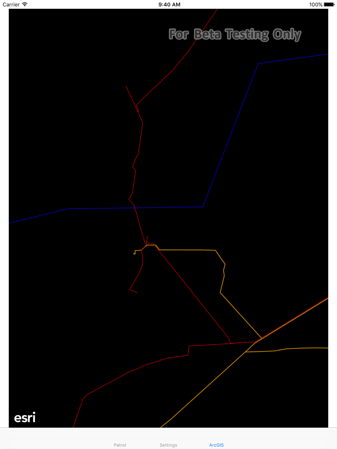

}Q3 & Q4 are related, I believe. I'm trying to minimize the data footprint distributed to my mobile devices, which all have to work completely offline. I'm really not wanting to include a basemap (to reduce size), and all I care about is showing the data from a few layers. Although there are no constraints on the mmpk export, the data is clipping weirdly on the device, and it's showing up on a solid black background:
Attempts to change the background color do not work -- the mmpk is actually inserting the black background on top of a mapview that has a solid green background color set.
This leads me to believe that a basemap is required to set extents properly.
Thoughts? Suggestions?
