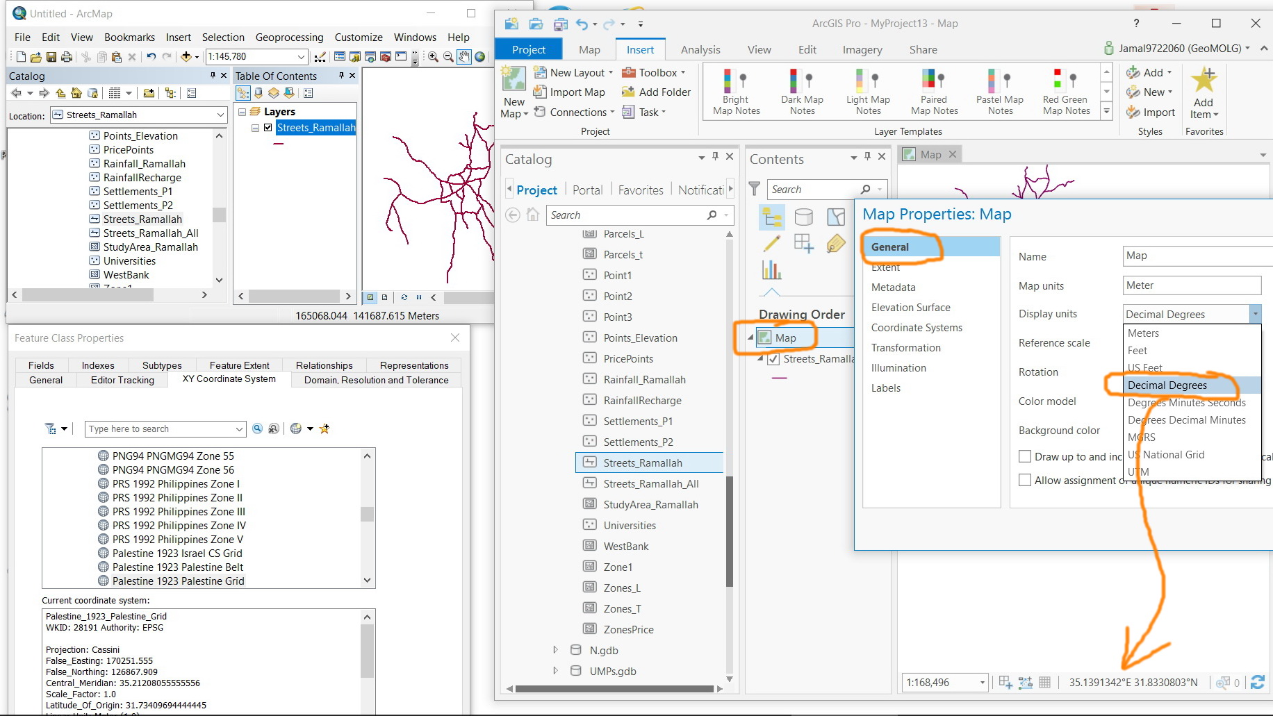

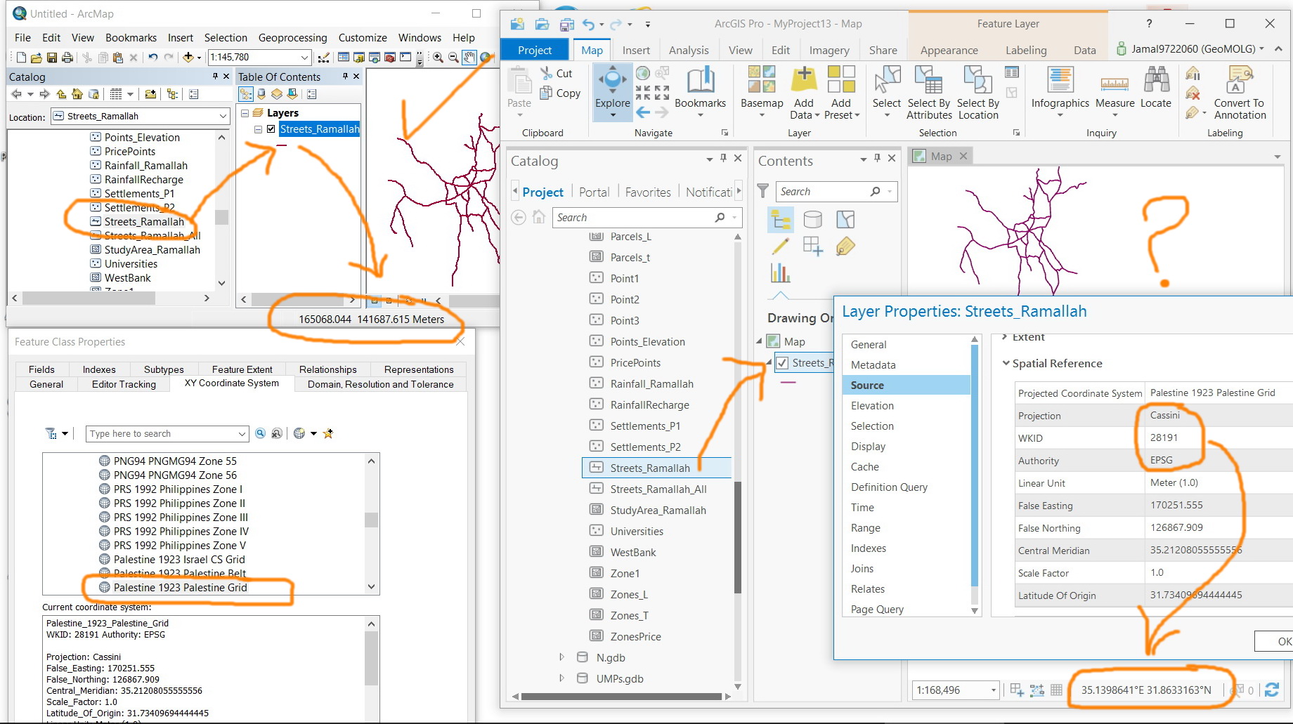

How about the default behavior of ArcGIS Pro when adding a layer with a defined “projected coordinate system”?
For example, in ArcMap, the “data frame” takes the coordinate system of the first layer added to it and thus the “display unit” shows its coordinate system. In return, when doing the same layer in ArcGIS Pro, the “display unit” preserves the “decimal degrees”!
Is this by design? Do we need each time to go and manually change the “display unit”? is this the best practice?
