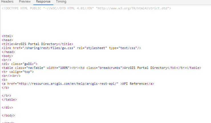

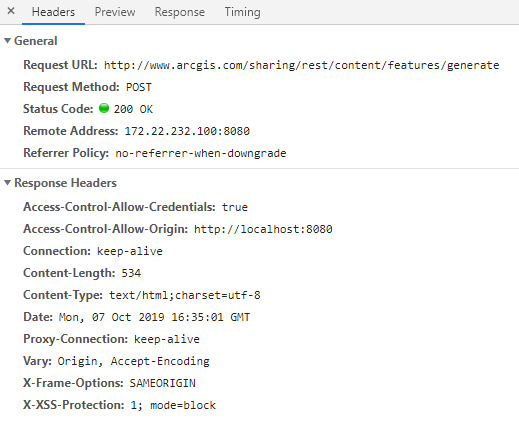

The application gives the following error:
This is the Network tab in Chrome:
This is my function:

The error occurs in esriRequest.
I have read this but without results:
https://community.esri.com/thread/213470-arcgis-rest-api-generate
and this:
https://stackoverflow.com/questions/23784920/im-getting-unexpectected-token-for-a-valid-json
I've tried also with esri.request (v 3.8) but without results too.
If you change 3.29 by 3.8 in this example https://developers.arcgis.com/javascript/3/jssamples/portal_addshapefile.html happen my error (unexpected token <)
Any suggestions?
