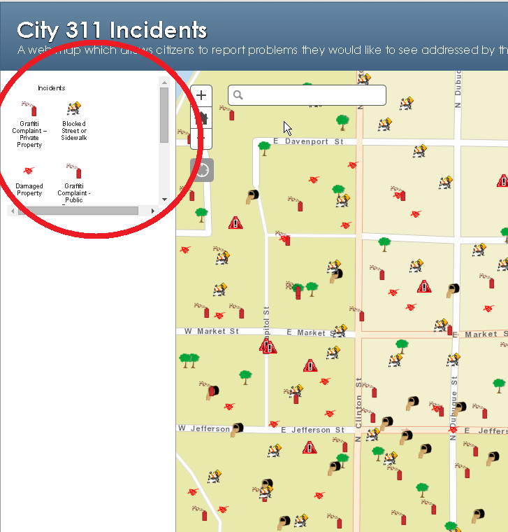

I downloaded the Esri's Edit web app template for use in AGOL and I'm trying to adjust the height of the table of contents or section of the window that shows the editable features, which originally appears on the left side of the screen. Here is what is looks like now: http://mapservertest.borough.kenai.ak.us/edit-template-master/index.html If you can't access that then see the image at the bottom, I've circled the area of interest.
Below is a snippet from the index.html file. It shows the width parameter as "240px" by default: setPanelContent(content_title , content , "240px")
But where would the height be? Maybe I'm looking in the wrong location. How is the height determined?
