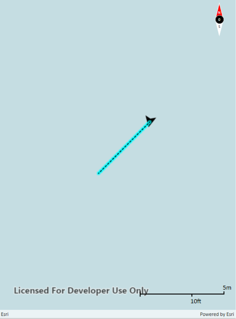

I'm getting the exception below when calling ShowCalloutForGeoElement. I assume I'm doing something incorrectly but I'm unable to figure out what. If I click on the dashed line in the screenshot I receive the exception at the bottom. However, if I click on the triangle I do not get the exception. I'm using v100.1 with WPF. Any guidance would be appreciated. Thank you.
Code Sample:
