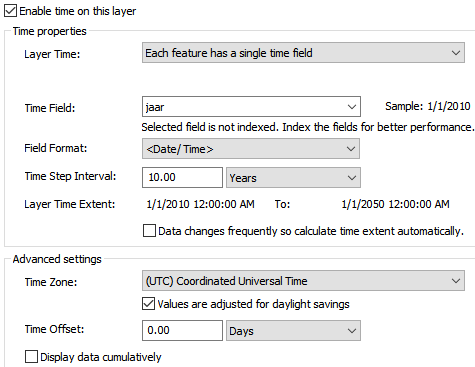

I'm trying to create an ArcGIS Online WebMap with a time slider on several layers from an ArcMap 10.5 project.
After enabling time on selected layers and configuring the time settings (interval, extent), I share the map as a Hosted Feature Service to ArcGIS Online. Inspecting that Feature Service in a Web Map, the timeslider settings are not equal to those configured in ArcMap.
In ArcMap the interval is configured as 10 years, the extent from 1-1-2010 to 1-1-2050, both in the layers properties and time slider options.
However, after publishing, the resulting Web Map has 4 year intervals instead of 10 y.
After including the Web Map in a Web App, the Time Slider Widget also shows 4 y intervals instead of the expected 10 y. Is there a way to make sure the time slider settings are transferred properly from ArcMap to ArcGIS Online?
